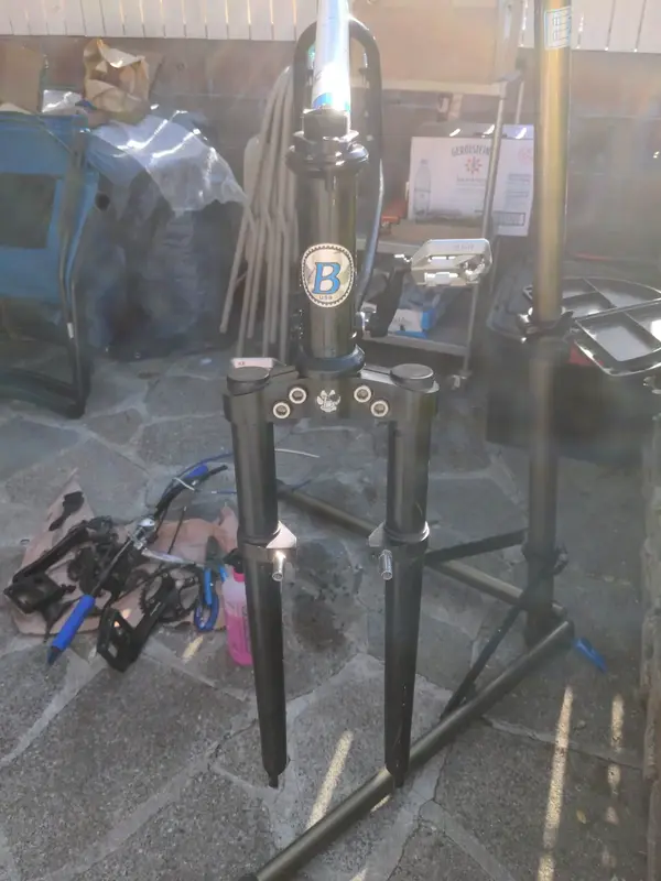

A few snaps I took while my buddy and I built it up

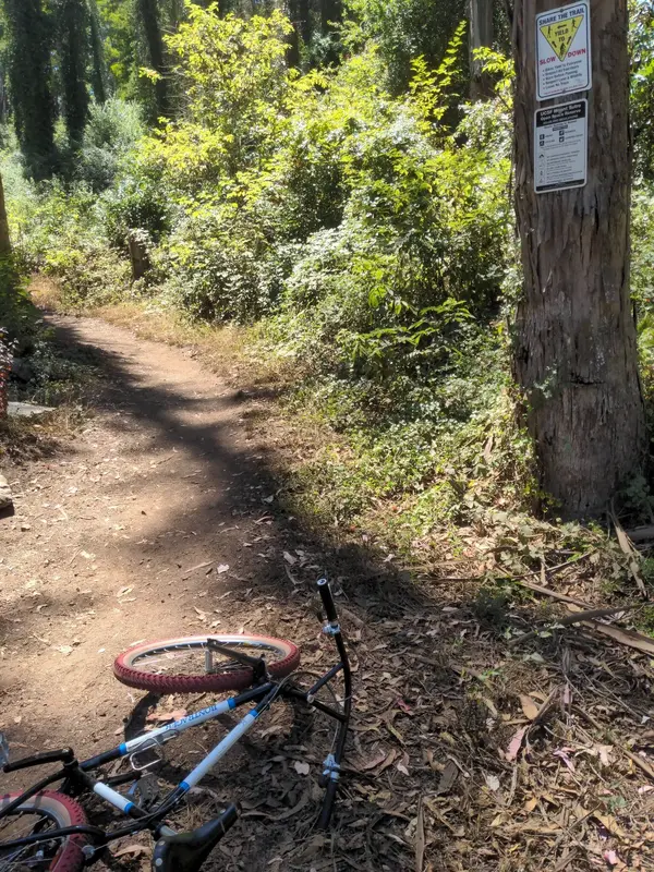

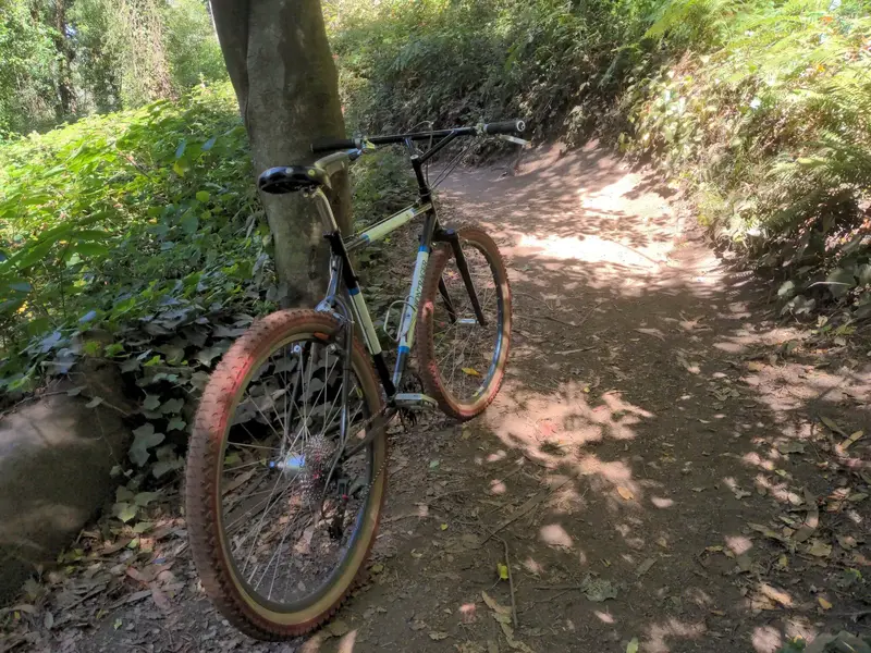

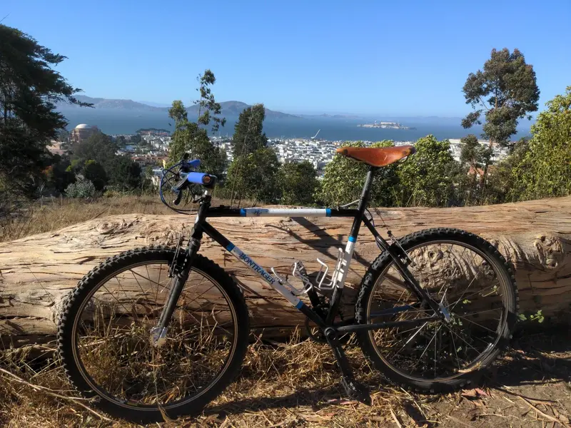

First trail outing - Mt Sutro in San Francisco
Another on a very different day on Sutro

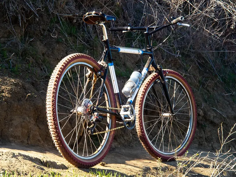

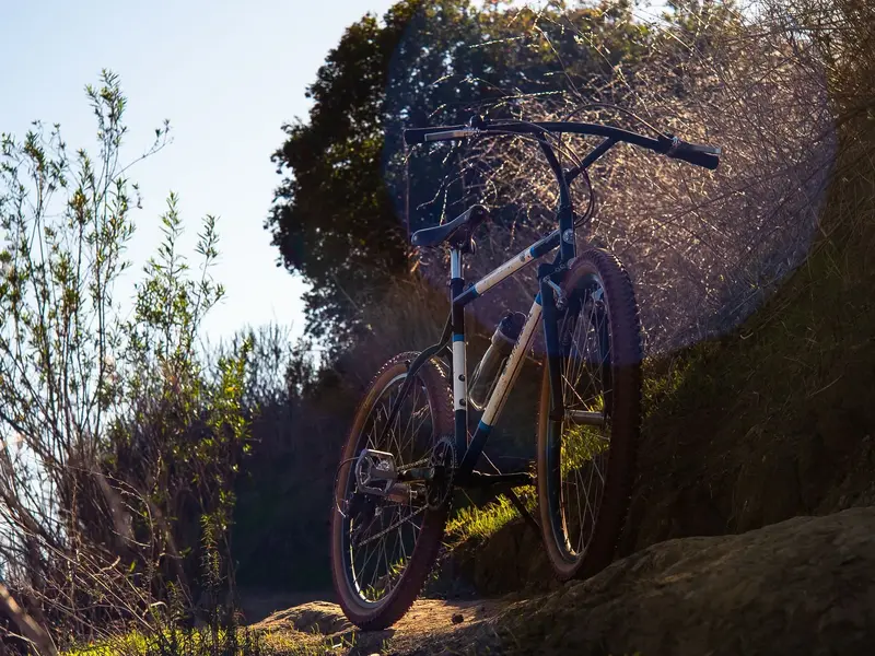

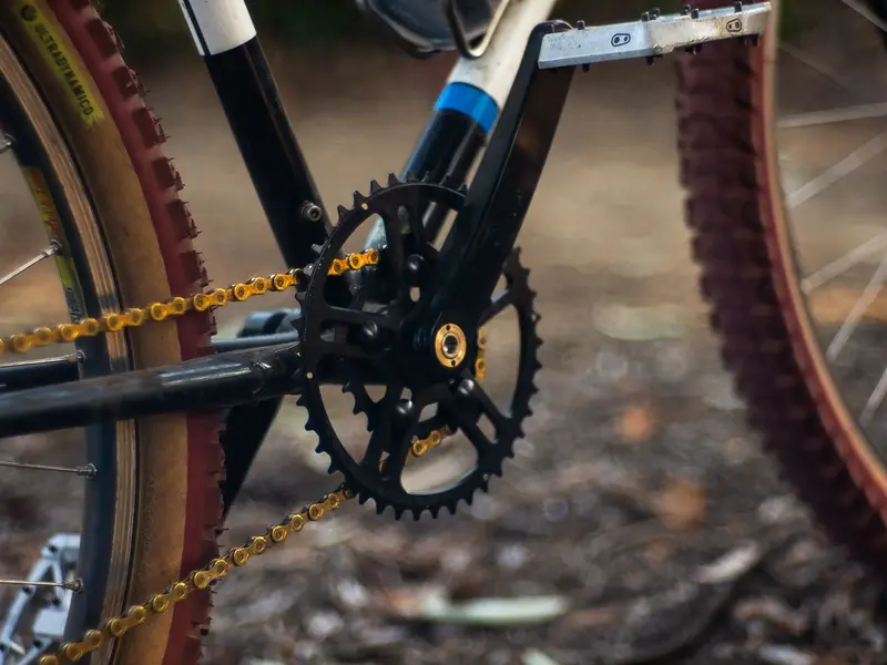

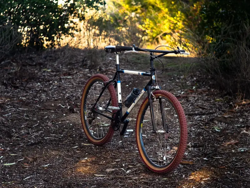

And these I took today now that the bike is with me at home in LA (🙏 @pw_pw_la )

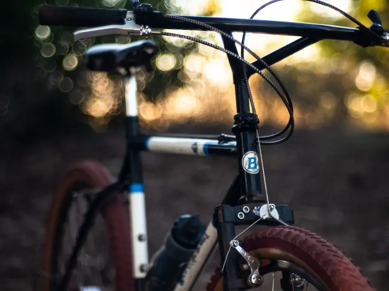

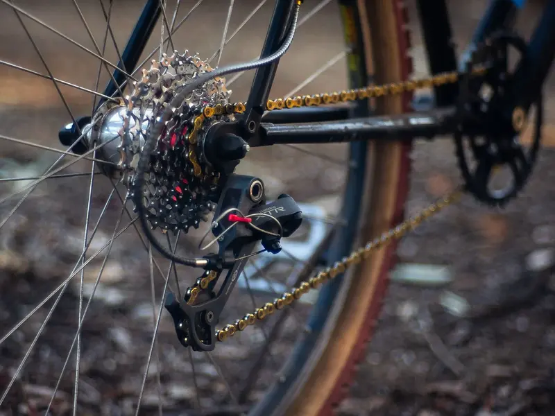

The deer head shifters weren't working for me. They shifted fine though after shifting to lower gears I'd take my hand off the shifter and the tension from the 952 rear mech would pull the chain back to the tallest gear so I was having to hold my thumb on the shifter to climb. Rather than try and figure out what was wrong I decided they were too chunky and swapped them for the XC pro thumbies that are working great.

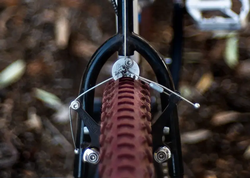

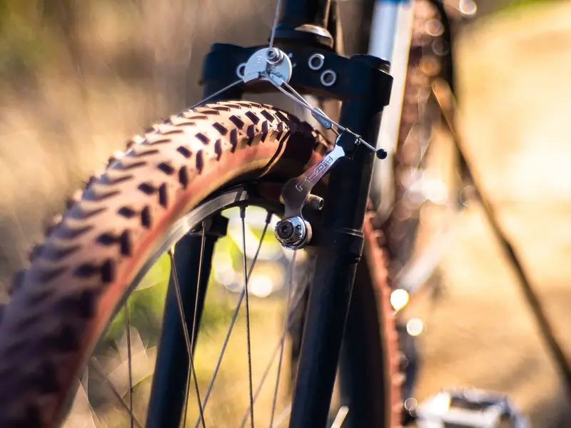

Still a work in progress. There is a frightening front fork jitter that I don't know the cause of. I raised the straddle cable and it maybe helped a little. I still need a pulley and a front mech and everything needs to be dialed and the cables trimmed.
At the very least I want to switch the chain and dust caps for silver which is what I initially wanted but the crank seller shipped the wrong color and my buddy lent me the chain while mine was still in transit. Maybe a black seatpost. Halfway toying with the idea of putting an XC Pro group on it but everything on it is really nice and works great so I think I'll just enjoy it like this for now.
I had lot's of front fork brake jitter on my 93' Kilauea after swapping to NOS 987 canties c/w stock DiaCompe brake pads.
The thought the triple butted fork might have been flexing? But no jitter with the old set and Kool-Stop Eagle Claw pads.
I was confident in my canty setup, everything felt solid and tight. The jittering was driving me nuts. I wondered if the old school DiaCompe NOS pads were to blame.
Ended up adding a fair bit more toe in to the DiaCompe pads and solved it. Might be worth a try
I trust the headset & front wheel bearings are tight...
I had the same thing with 987s on my Bonty fork, really disconcerting judder, toeing the pads in lessened it a bit, swapping to a Shimano brake got rid of it completely. Bikes looking great. :)
I had the jitter problem to a slightly lesser degree with the found setup with a pretty spent Specialized headset and Tektro calipers. I thought one of those two were the culprit but it's worse as is now. Under heavy front breaking the fork flexes fore/aft wildly.
These have loads of toe, but I need to revisit the whole setup. Headset was new and installed properly but I should check again the front wheel.
Fantastic looking ride
Thank you! I'm pretty pleased riding it too.
Thank you! Maybe that's it, swap the calipers.

Really glad to have played some small part in getting this wonderful machine back in your hands mate!
And I can confirm first hand that that fork chatter is the most frightening of any bike I've ever ridden!
Perhaps the Paul's are just too much for it? But that too still seems odd to me.
I've had no trouble with them on the Brodie's Gatorblade (completely different fork, I know) and like others in here, have had no issue running a classic M732/35 caliper on my Bontrager.
I would definitely make sure that headset is airtight, the stem too, and all the bolts on the Composite crown.
I suppose you could also bang in a traditional welded fork of some kind with that brake on it to compare?
