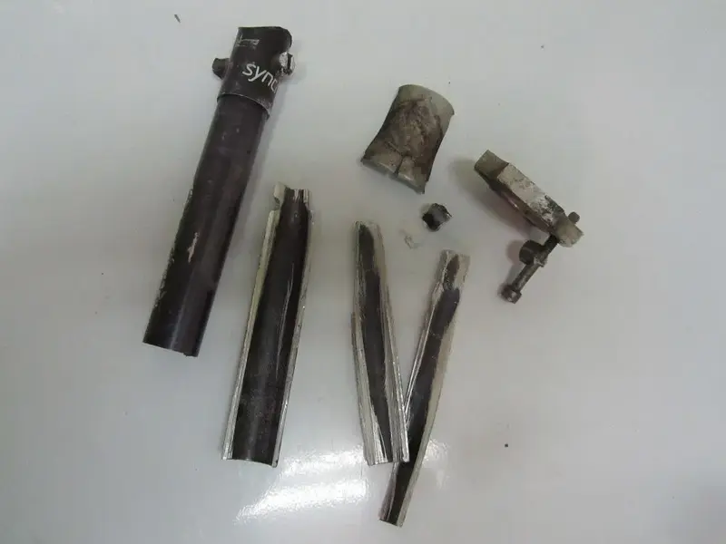

This is the sad story of my Syncros (1st generation) seatpost.
So after noticing it was seized, I used some penetrating oil and let it sit for a few days. Then I held the frame upside down with the my foot on the saddle and twisted and twisted the frame until I heard a CRACK! I was pretty excited that I freed the post...but it hadn't budged and I noticed a crack in the lower semi-circle clamp.
I figured, ok, I can still use it somewhat with a small crack. Then I rigged up the vice and tried to set it up as to not damage the clamp. I was torqueing the frame so much I was worried about breaking the frame then BANG! the whole upper cross cylinder exploded apart.
I cursed. I almost cried. :facepalm: Then I put the frame away for 2 months.
Everytime I went down to the garage I was reminded of the battle and KNEW I had to get the damn post out. So I researched a bit in the forums and figured it would be best to cut the post off an inch above frame and make a cut all the way down into the frame...did that put it back in the vice and it still didn't move, and unfortunately broke off some of the post sticking out of the frame. So I cut out a quarter section of the post, put it back in the vice...still no movement! Lastly, cut out another section of the post and WOOHOO it was free! I then drank a beer.
Don't ask me how many hours it took. Below are the remnants of the battle. Yes, it's sad. :cry:
Anyone have a 1st gen 27.0 Syncros post they'd like to sell???

my, that seatpost looks mangled and ravaged! looks like you took a grenade to it. :shock: wow, i feel for ya!
sorry to say you're gonna have a VERY hard time sourcing a 1st gen Syncros post. you'll already have a hard enough time just getting any 27.0mm Syncros post in fact, as ppl tend not to want to give them up. maybe you can convince shutter to give up the one he got from me. ;)
regarding insertion, you should have enough seatpost inserted in the frame to go past the lower edge of the top tube where it and the seat tube junction to avoid frame damage/failure.

I looked into this, they would be very easy to make if you can find the right OD tubing that is thick enough in a reasonably strong material. I wouldn't use stainless unless it is thick and then it will be heavy, if it is thin I think it will stress the rails. The problem is finding the right OD tubing. Let me know how it goes. Some hand made lowers combined with the upper parts for a USE could work nicely on 1st gen post.
The uppers are a little bulky for later posts though and the bolts are too long and not threaded far enough down... but these work great for 2nd gen posts (note 3rd and later gen forged uppers to not work on 2nd gen posts very well due to the way the holes for the bolts are made, they don't allow for the angle which the later uppers necessitate).
