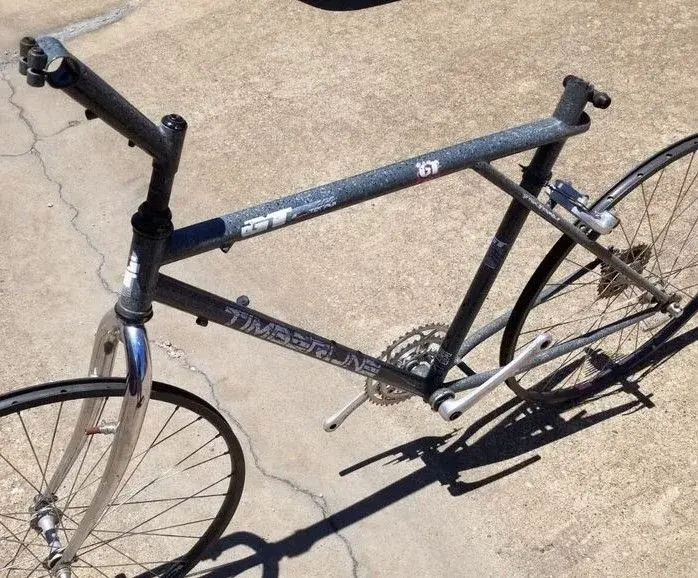

Nice, I’ve always like the ‘granite’ paint job on those.
In terms of forks, your best bet might be to buy another frame as they rarely (but occasionally) come up on their own.
Otherwise, black goes with everything!
Plus if your chrome ones are Tange or even Koski forks, they’ll be worth selling!
