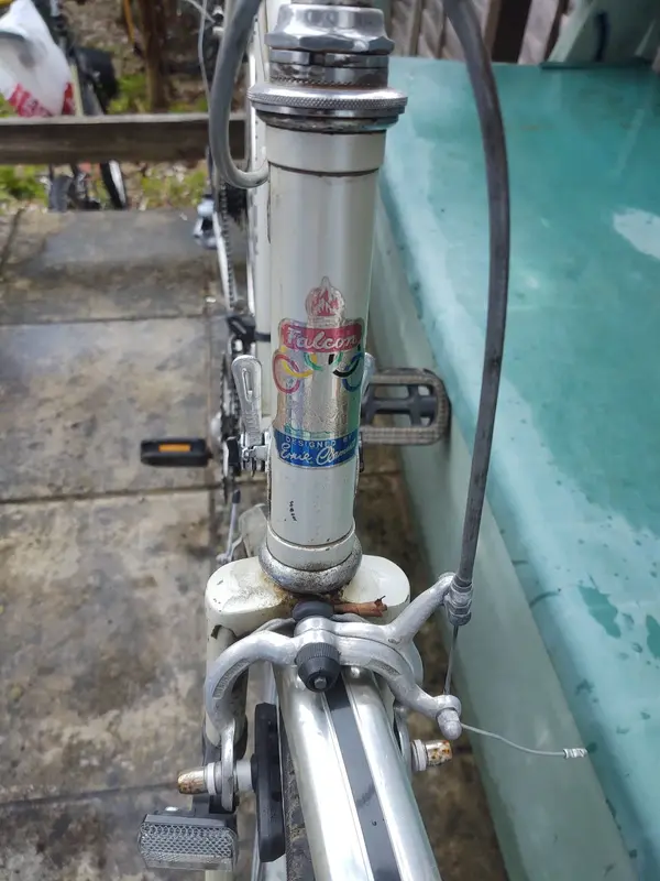

Afternoon all,
I took a punt on 2 old road bikes on the basis of a couple of poor pictures and put in an offer which was accepted. One is a Falcon and one is a British Eagle Touristique (well actually it turns out it isn't but that's a story for another day and thread!).
The Falcon is destined to be my station/shopping/pub bike for now with a minimal outlay recommission job. Can anyone work out it's age and model? I am thinking early 80s and a Mallorca/Majorca?
I'll put a couple of pictures up and tell you what I know about it from a brief look whilst dodging downpours. It has clearly been well used and updated so I don't know what parts are still original but some parts clearly aren't. For instance it has a Shimano 200GS FD, a Stronglight Escapade triple crank and a Shimano RSX RD.
It has a cromo frame and I think the fork dropouts are Tange. The seatpost is 26.2mm and very long. The photo shows it at minimum insertion depth for a laugh.
It should scrub up nicely with a strip, clean, lube, and repair. I may even try a bit of bargain retro bikepacking on it!
Looking around the internet some more, including finding a thread on this very forum, I am now convinced it is a Falcon Majorca. It is apparently pre-1981 as it does not have brazed cable guides on the top tube.
In between showers today I have been busy.
The stem was lowered so the minimum depth marking was below the headset not above it!
I swapped one tyre and two tubes.
The seat height was adjusted to an approximate measurement, brakes checked and a quick test ride shows that it is a smooth ride. Lots of cleaning and adjustment and I am sure a few new parts will still be required but I think I am going to like it. But boy did they like narrow bars back in the day. I think if I keep it as a beater bike it will get wider bars!

Interestingly the forks has several chips anf scratches on it and it would seem it is either fully chromed or part chromed!
