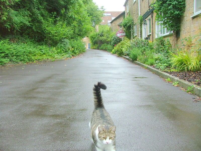

We have a 4-5 feet earth bank down our private lane which is being washed out by the rainwater runoff from adjacent site. A wall would seem like a perfect solution. I'll propose it at our next residents meeting in Jan 09 .

i would be happy to give you a price for a retaining wall... but it would have to be built properly with stepped foundations, DPCs and drainage.... i wouldnt want to travel and be asked to build a wall that was just "thrown up" , my work is quality....period.
its the only way i work.... this often means i can not do cheap jobs..... but you get what you pay for :wink:
