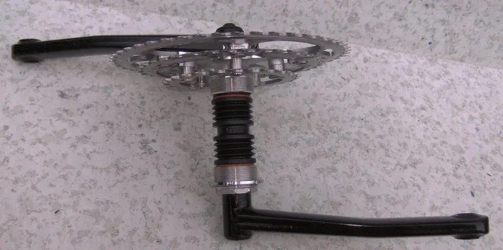

i had a set on my shogun some time ago and the spider and crank arm just slot together by compression re the ahead set method...i had a slight play in the axle as well from what i recall...i had my arm replaced as i broke the stud on the crank arm when sprinting hard....i then had them stove enamelled white...looked real good too...
maybe this helps
Lars
Hi Lars, that's perfect, so it seems I'm missing the three spacers that fit between the crank arm and cup. You don't happen to have ant measurements for these do you, as I'm going to need to hunt some down.
Thanks
Ian
