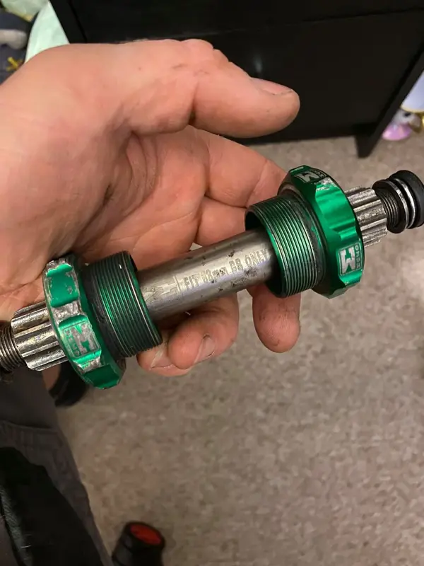

Echo used to make a unique ISIS bottom bracket that used external cups back in 2006. Bearings could be extracted & new ones pressed in like a Shimano, Gusset or Hope Hollowtech 2 BB can. If someone asked Hambini, he could make an external cup ISIS bottom bracket similar to the Echo pictured.

I'm pointing out that not all ISIS bottom brackets are created equally. Just because the majority of MTB brands are using cheap clones - does not mean every single ISIS BB out there is inherently bad. There are many riders out there who want to keep using their ISIS Middleburns, including the OP of this thread - so I have offered 4 alternative ISIS BB solutions:
- SKF
- Trialtech Sport Lite
- Echo External
- Asking Hambini to make you an external-cup style ISIS BB.
What solutions have you offered?
I have worked in bike shops. So am aware that the general perception of owners, managers, and ground level staff tend to assume only negative things about ISIS. None of them are trials riders, and thus they are totally ignorant to the fact that certain trials companies like Echo and Trialtech have gone out of their way to manufacture ISIS bottom brackets that are far more reliable than the standard MTB branded clone offerings. People assume too much.
Consider how poor the bearing life is in almost every brand of external-cup Hollowtech-style threaded bottom bracket. Especially for 30mm external cup BSA threaded BBs. Less so for the 24mm Shimano HT2 ones, though the bearing longevity issues still remain, even for nicer BBs like Hope, WMFG and Chris King. Not uncommon for many brands' non-drive side external cup to have gritty or dead bearings in under a year, sometimes under a month for some people with some brands of BBs. Sounds similar to problems people had with catalogue cloned ISIS BBs.
"Why does no-one use Isis anymore." - Actually the majority of Trials riders still use ISIS bottom brackets & cranks to this day. Many out there still using several-years old Trialtech Sport Lite BBs. Some still rocking the even older Echo External BBs. Most trials cranksets are still ISIS. Most brand new complete trials bikes still have ISIS BBs and cranks.
