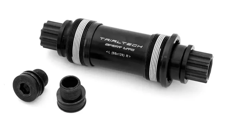

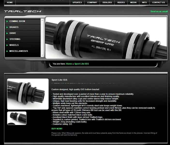

SKF or Trialtech. Better designs than other brands
