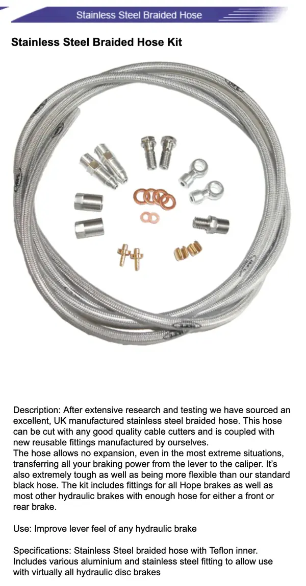

4) Can I install a 6 mm braided Hope hose with the original hydraulic fittings by installing the 6 mm olive right around the outer plastic skin and then screw it together?
I originally came across this youtuber who seems to know a lot about Hope brakes who does it exactly like that (
But then I found that when Hope came out with their own braided hoses they sold these together with the then new 5 mm olive and new 5mm hydraulic fittings right from the start:
For this, I figure one has to strip the outer plastic skin before installing the 5 mm olive right on the metal braids, otherwise the smaller olive won't fit.
Any experiences whether one method (plus parts) is better than the other? I'd favor less tinkering so would be happy to skip skinning the hose first.
