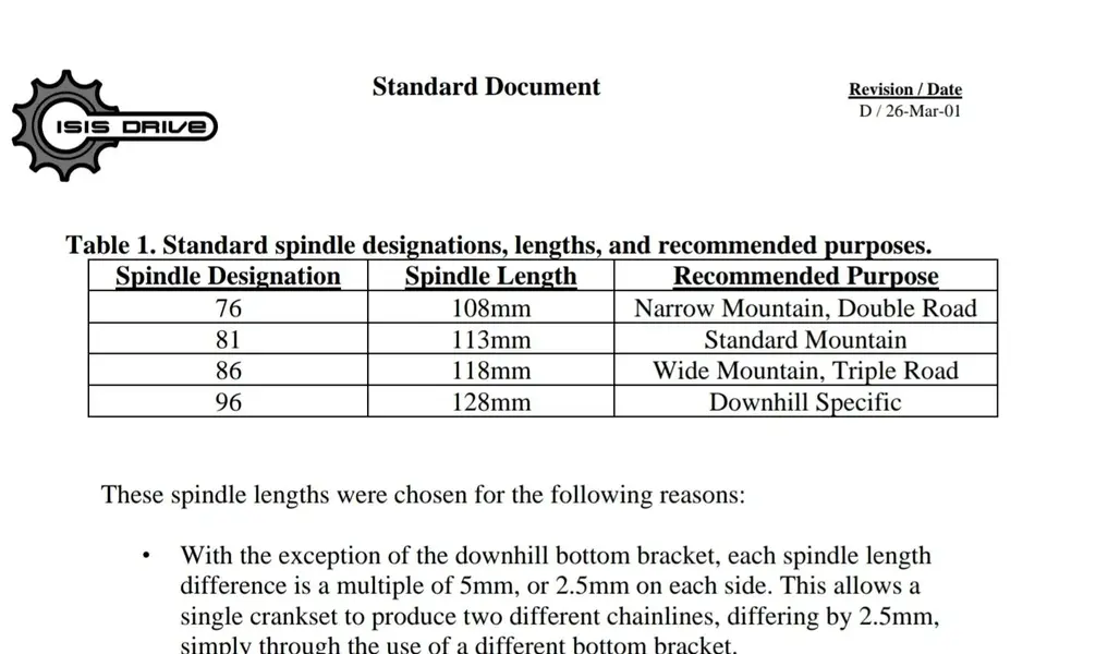

Pretty sure you need to use the 128mm (downhill) axle, as 118/113 are mtb standard and road is even shorter.
Anything else isn't ISIS.
On the ISIS Drive official page: https://www.isisdrive.com/menu-3 - there is no mention of how wide or narrow the axle must be to qualify as ISIS.
If there is an official rule about needing specific width axles (e.g. 113mm, 118mm, 128mm) to qualify as ISIS then I'd be interested to know where you got this information from! If you can provide credible primary sources or official documentation - even better.👍 Always good to learn new things every day. :)
You cannot compare square to isis.
ISIS standard has 4 fixed lengths so you know your crank will just fit and work. The crank is then designed around that length.

As for lengths.
Grab the spec documents, it's a pdf under documents.
The Overdrive spec pages don't seem to work for me but you can get at them.
I might need to try a different browser.
I'm surprised the BMX/Trials users didn't go for that, but that Spanish spec looks reasonable.
Here's the table snippet.
