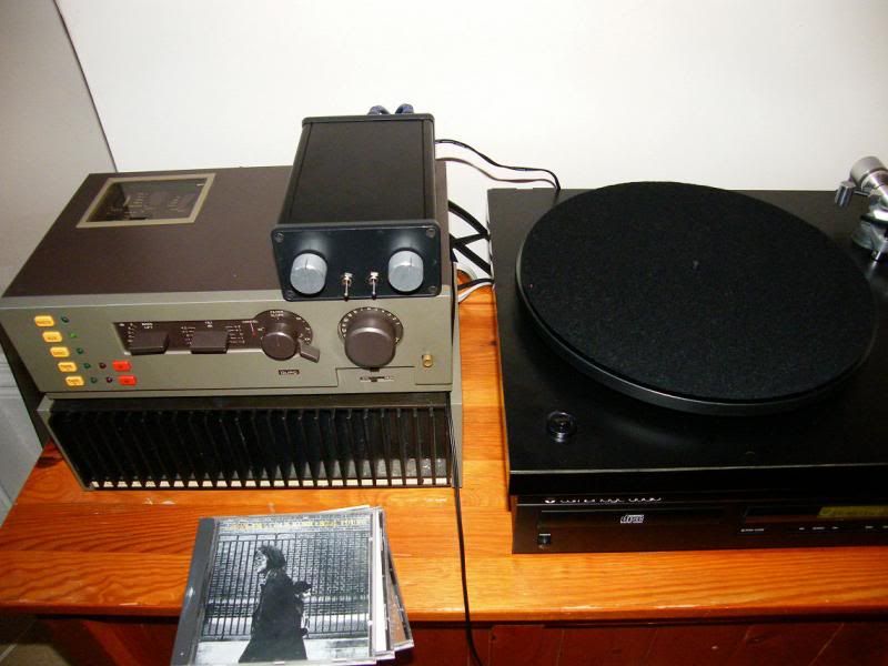

It does indeed - especially with the lid on, working perfectly and completely inaudible in circuit (to me anyway!) between 'flat' and 'bypass' :)
Finally happy with it!

All i can say is thank you so much for taking the project on and doing it so quickly , pm me the price when you ready, i'm not far away so could pick it up no problem. What bass/treble frequencies did you use in the end.
Quickly?? Took me ages by my standards! I had a prototype headphone amp in an evening! :D
Will dig out my notes for turnover frequencies later, but the bass is shifted down from standard baxendall configuration to 400Hz turnover with max operation at around 20 - 30Hz, and treble upwards from standard 1kHz to around 4kHz with max effectiveness starting at around 10kHz.
Obviously, with a tone control, it's not a steep / step response (that would cause huuuuge phase shift problems) so there is effect below the peak, but I've shifted them up and down from standard. The bass lift works brilliantly with the new Public Service Broadcasting CD! :)

Parts cost (the majority of which is the box, the op amps and the power supply) was in the order of £55.
