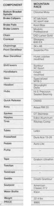

Until other documents prove otherwise, Gary Klein is likely to have sold the first production MTB that came factory assembled with Dirt Drop bars in 1985. The Mountain Klein Race presumably did not sell well because there are very few (or no?) surviving original examples. The Race specification presaged (or perhaps mimicked) a lot of Charlie Cunningham design elements, including flared drops--with shifters mounted inboard of the brake levers--and the use of Harlan Meyer's lightweight hubs.
Look ma, no bar-cons!
I believe the above picture shows obvious added handlebar sweep, if not much flare. We can hope or assume that the "modified Cinelli" handlebars were heat-treated after bending, given that Klein was an established aluminum outfit. I believe that the shifters are just normal SunTour 4700 XC-Sport Power Thumb Shifters, with the only modifaction being necesary for mounting in that position being the use of a different bar clamp band.
If someone has the Mountain Bike Action Magazine review (1986?) of the Mountain Klein Race, scans would be very appreciated.
