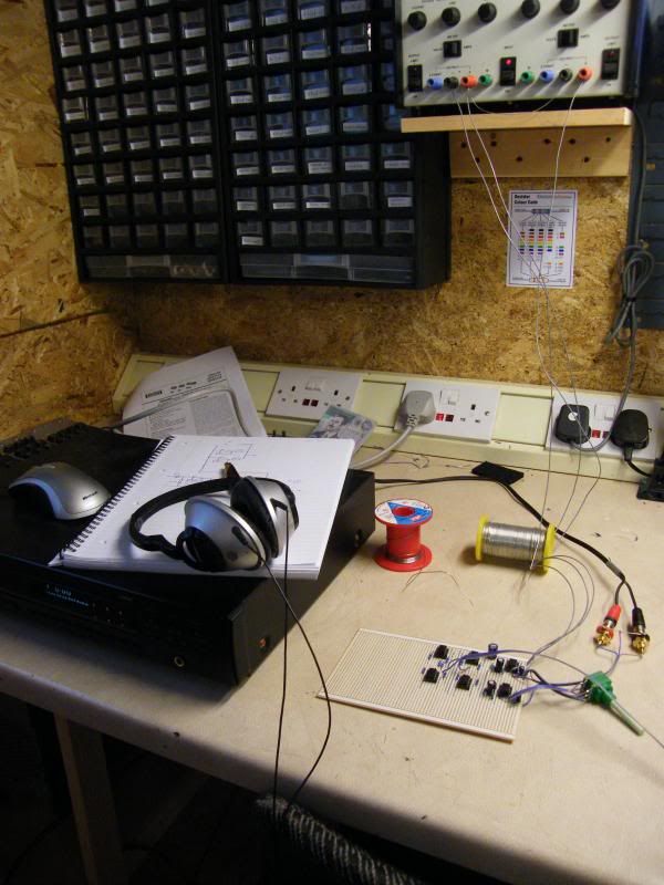

Dissipation sorted - if in doubt, parallel more devices! Changed the first stage to a gain stage, prior to the volume control - gives a small theoretical improvement in noise floor, it's already lower than I can measure. I need to make the second stage a voltage follower as with the gain there there is now a bit too much 'oomph' (even into the 30 ohm Bose!) and it would be easy to cause ears to bleed!
It was easier to move the CD player to the shed than move my shed to the listening room! Sounding good - very strong fast sound. Measures well, so it should do.Maybe I should give it some bling power supplies for street cred :D

Just finished tweaking my headphone amp, so I think the core design is done now. I reduced the input gain a bit, and changed the op amps to a low input offset voltage fet type, which allows me to DC couple the whole thing. The output stages are still bipolar types as they have better current drive. Sounds excellent, and I spent an hour listening to it when I should've been designing the power supplies for it!
Haven't done the PSU yet, but will split the regulators between the output stage and the input / buffer stages so the higher current bit can't modulate the power supplies of the voltage amplifier.

Getting quite excited now (sad I know) as I've measured no increase in distortion on +/-5v rails (as opposed to +/-15) which means I can power the fet input stage via rail bootstrap, which means you drive the supply rails up and down with the music signal, which in turn reduces common mode distortion (thanks again Doug!). The output stages will be on the raw regulated +/-15v rails. Starting to look like a lot of effort for a headphone amp, but hopefully will be worth it! :)
Hey... +/-5v probably means it's possible to 'portable-ise' it... :o
