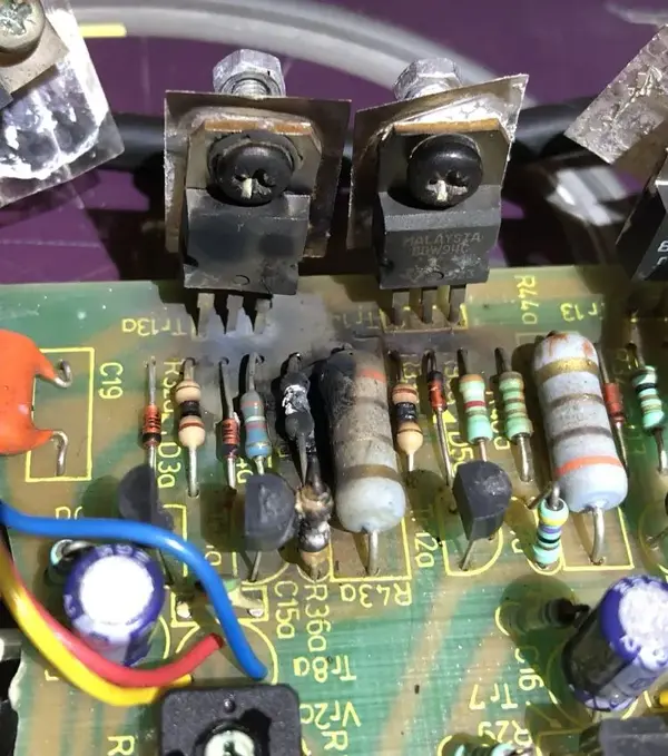

I’m original owner of Ion Obelisk 1, the original Powys company, a wonderful small amp. It cost about 120 pounds in 1990. Right side output recently smoked and died. Took off the lid and found some cooked toffees. Asked around, found a company, they quoted over 400 pounds to fix it.
Thought about having a go myself to replace the burned components and see if it works. I’m an ex-automotive electrician but don’t have experience in diagnosing or measuring electronic circuits.
Is this a good idea to try? Or need to give to an expert? Not sure if any circuit diagrams exist anymore.
I have a newer and more powerful amp but prefer the sound of the Ion.

^ If you can wield a soldering iron, that should be fixable with little expertise and test equipment.
Your issue will be to ID the toasted parts, but since there should be symmetry between the L & R channel
you should be in with a chance. Use the web to find equivalent parts. The small black potentiometer (Vr2) may
be there to provide a DC bias so a multimeter / oscilloscope would be useful.
Replacing components (even if you are unsure what they do) can go along way. Get the channel working,
then likewise update the other channel with the same newer components too.
£400 is way too steep IMHO.
expensive quote! I had a large JVC go pop and it was £90 all in
if you can find member Apache on here, he may be able to help. He is also North Hill Audio on face book
Hi chap. I've sort of retired from Facebook for a while due to the weight of assholes.
Have you looked at hifi engine for a circuit diagram?
