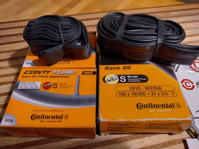

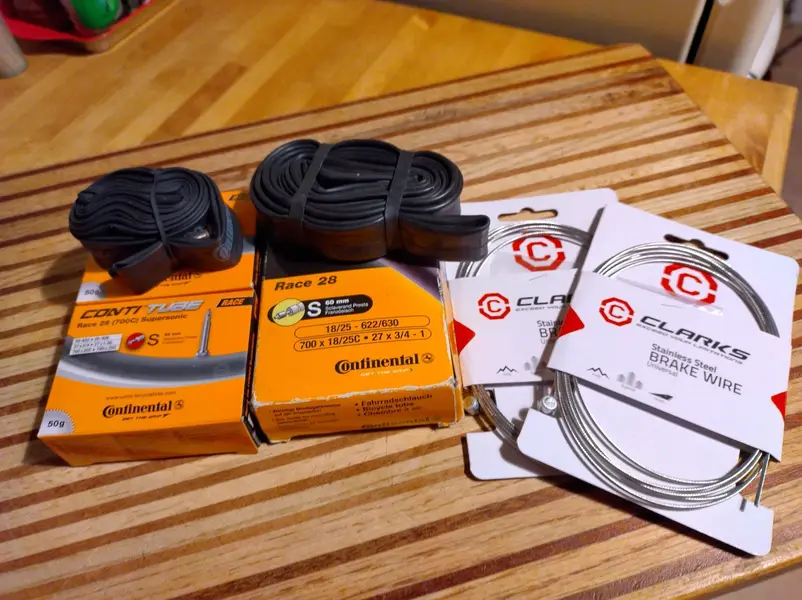

Currently running wire bead Gatorskins, as it’s all I had in the stash in 27 1 1/4. 75-80psi with no drama. I am planning on fitting something nicer but cannot really find anything I like in the correct size...
