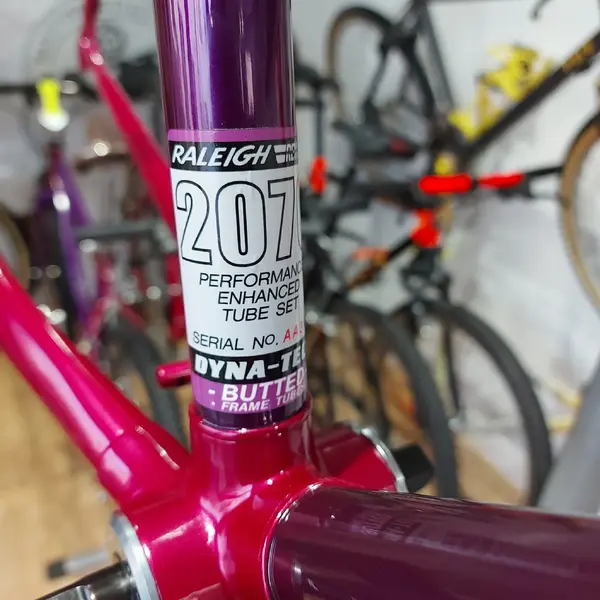

Oh and one thing I was going to ask anyone who might know...
The 2070 sticker has a serial number on it - but it doesn't match the frame number. Should it? šŸ¤”šŸ¤·ā€ā™‚ļø
The 2070 sticker serial number doesn't match the frame number.
The frame number should read something like B 0XXXX
If you removed the sticker, you void the warranty!

boy"O"boy
Frame number on mine is A26050
and Serial number AA1991
My 2 Endeavours are -
#1 ~ BO5078
#2 ~ BO27270
Both Serial numbers start with AA
From what I've read on the codes
A= 1990
B= 1991
I'm sure someone on here would know more.
Cheers.

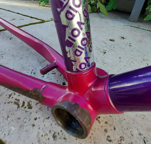

An opportunity arose recently to acquire ā€œA Raleigh Dyna-Techā€, which was followed by a fuzzy non-drive side photo :rolleyes: of what appeared to me to be something of interest, and with the expert help of @Markybeau and @boy"O"boy I was confident that what I was looking at was a 1990/91 Dyna-Tech Pro, so a purchase was made :cool:
Doesn’t look too bad in the pictures, but I think it’s come to me just in time really as it clearly hasn’t seen a workshop in a long time.
Simple plan with this one will be to strip it right down, clean it as best I can, rebuild it, and enjoy it for a while before deciding if it has a permanent/long term place in my collection. I’ve got to say that I’m a fan of many bikes of this age - around the 1990 mark, so it stands a good chance of being a keeper.
The suggestion that the frame is the same as the Endeavour of the same vintage appears accurate from a few of the key details:
The specification is certainly not the Suntour XC Pro that it should have, but there’s evidence it may have been as the BB is a Suntour item.
At least it has the correct headset - albeit not yet undone…
For now it is just a frameset and a box of bits, but with a little luck and a smidge of time I should have this one up and running pretty quickly šŸ‘
