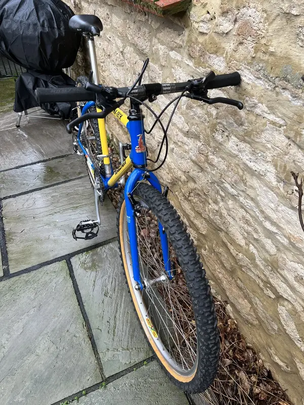

Love this. Such a nice looking bike. I had one myself but had to let it go

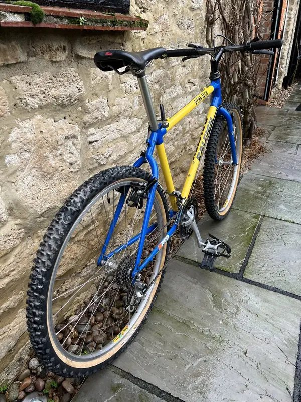

Really enjoyed putting this one together, I think it looks better in the metal than pictures - largely down to my photographic abilities!

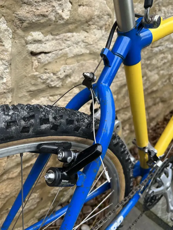

Couple of points I’m not happy with or would like to correct;
- stem; I’d like to find one more in keeping with the OEM, with the internal cable routing
- bars; currently wearing a set of very narrow, badly cut Taperlites
- saddle; it’s a ‘92 Flite. I have nothing earlier than that in my spares.
- seatpost; I think it’s supposed to take a 27mm, but I’ve struggled to get a 26.8mm too far in without unnecessary twisting

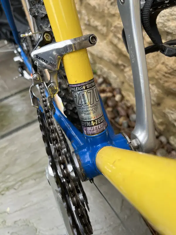

The team colours look ace - nice that it's all original patina. Does the number on the fork mean anything?
Love an XC pro build - classy group set. I've got to get my Off-road Serotta Pro-flex on the go again....I've finally scored the missing XC pro parts that I've decided to go with on this build.
Saddle wise.....what about a Vetta Lite, or a Selle Italia turbo? .....or a San Marco?
The Endeavour came with a Campagnolo Electra that completed the group set....got them on mine but they are crazy money £££
Interesting that the seat post is 26.8mm.
Both my Endeavours (same frame) are 27.0mm. Maybe it's the integral clamp that's been tightened a bit far previously that's holding back the 0.2mm?
The only thing that's bugging me (or my OCD!) Is that the rear wheel has been built with the Mavic sticker the wrong way round. Easy to change on the front....just turn the wheel the other way round.... Harder to correct on the rear.
.....but a lovely build. Nicely done and well thought out. A winner 🏆 for the Dynatech fan! 😎😎
Hoped you or other DT experts might be able to shed some light on that, I'm guessing nothing more than just a batch number?🤔
I was curious to see what the paint underneath was like - in case it was simply an Endeavour over sprayed in the blue and yellow, but it appears to have the grey primer beneath so it looks like a 'proper' paint job.
Has a bit of cable rub on the blue lugs which is revealing the yellow of the main tubes beneath so it appears they did grey then yellow (without masking) then the blue.
I need to look for a Turbo for my Ultimate, but a San Marco is a good shout - I'll keep an eye open for one 👍
It came with a 27mm Zoom post but it was a very tight fit, down to being gummed up/corroded I thought. I only had a 26.8 XC post to hand, which I thought after a thorough clean of the seat tube would fit in easily - but it didn't. However I've not done it up tight as a don't want to encourage the seat clamp to get used to a 26.8. I now have a 27mm XC post, so I shall be fitting that.
I hadn't noticed! I'll turn the front around! :LOL:
