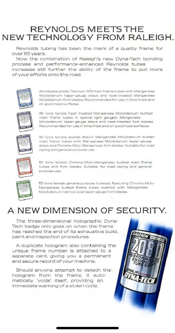

Here’s a screenshot of Raleigh’s specs for those tubes. You can approximate roughly what that means in Reynolds equivalent numbers from their own specs if you like. Last time someone tried that we had several pages of disagreements!
Awesome, cheers both.
Gives me more of an idea - I've had a look through the various catalogues and can't see the particular frame in question.

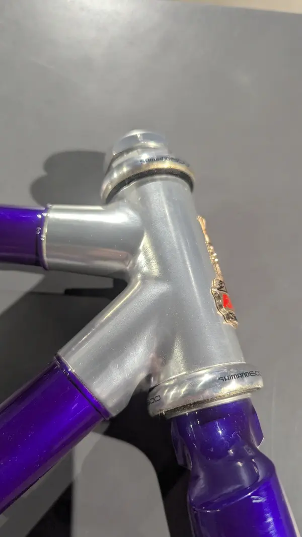

The only real question now is about the headtube - it's smooth and rounded like it's been brazed and smoothed but it doesn't have any visible joins or welds - is it just a really good finish or was it cast and polished or something else entirely?
I might be wrong but suspect they are some sort of cast alloy then smoothed down. I’ve got a Dyna-Tech Pro with that sort of headtube and that’s what I’d guess.

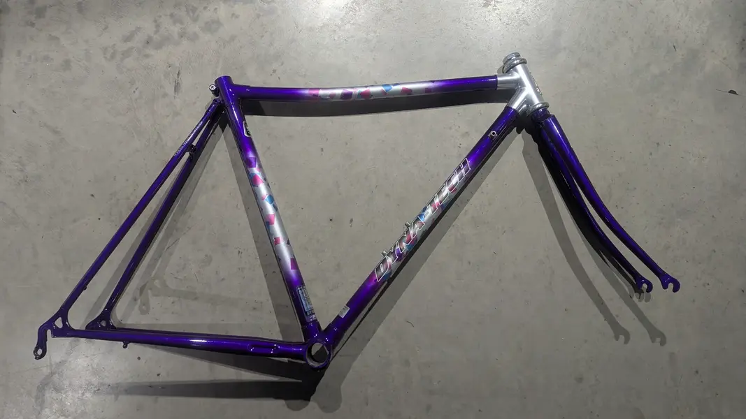

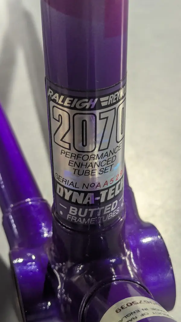

Took some photos for the classifieds, thought I'd drop them into here just in case anyone fancies a look... 1000031892.webp 1000031898.webp
