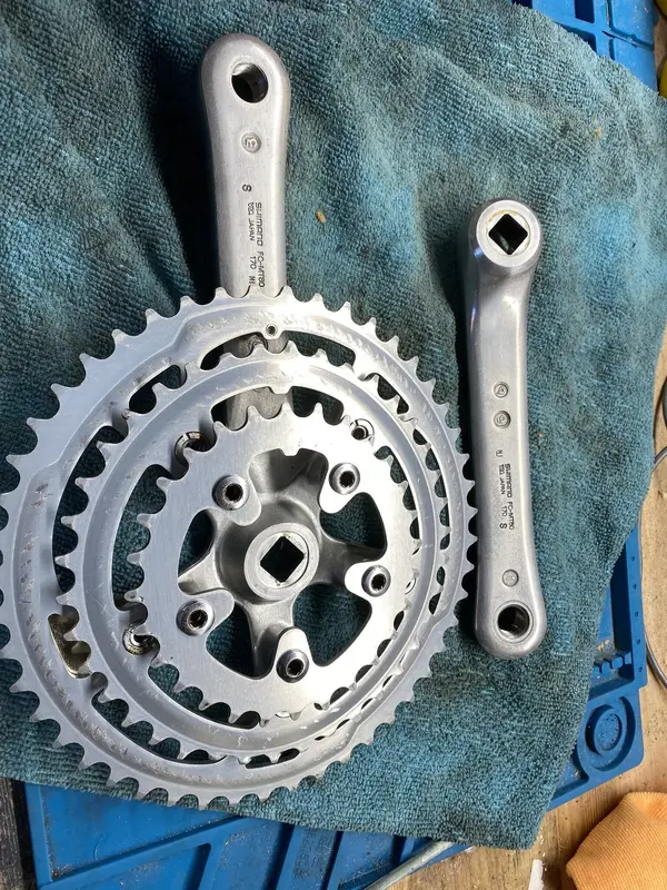

The DX kit is in great condition, had time for a good clean on the chainset today.
Before

After
