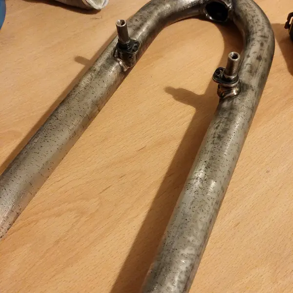

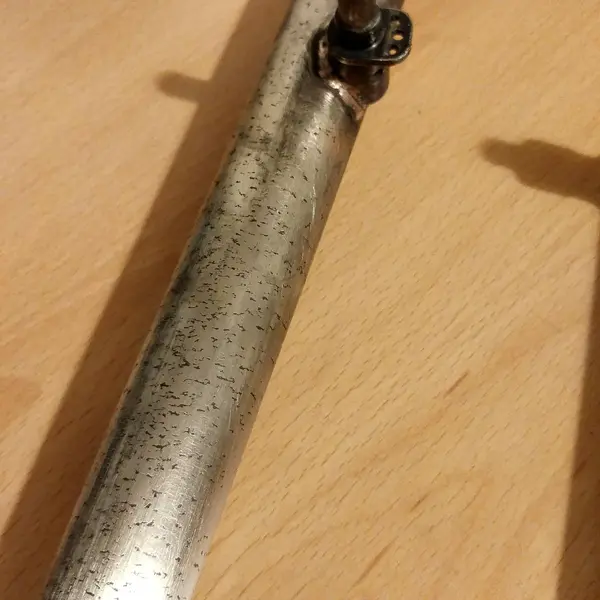

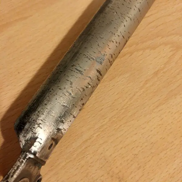

Found a set of P2's that were covered in rust spots and rather than bin them wanted to see how bad it was, hence I sanded them back.
The rust is gone but the steel is left as pictured?
Was thinking of finishing the job on lugs etc, sticking some kurust over it as a precaution then some coats of a decent primer. They're not meant for show but more of a save project, just interested in thoughts on state of the steel.
Thanks

get a brass wire wheel on them, clean then etch prime them. follow up with high build primer and wet sand back to get the dips out
Yes. I agree with above....deffo brass wheel to het all the corrosion out of the pits, then if your really worried give them a coat of krust, but rub them right down again before spraying with a etch and high build primer. May need a few coats and a few sands until they flat out.
Then spray as normal.
Best of luck.
