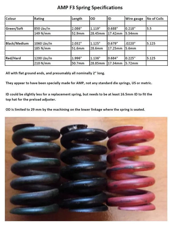

I found an fleabay listing for spares which had charged £10 each for a red or a black spring for a fork like mine, sadly sold.. but it means that when I find one it needn't be extortionate.
I have a spare fork spring, happy to match your Fleabay find price + postage.
Middling black or firmer red available, as I'll just fit the other one back in my fork, which is not one of my ridden AMPs.
For the record, here's the full spec for the fork springs that I put together:
AMP F3 Spring Options.jpg All the best,
Nice thing with the F4 is you can use one of each. I use a black and a red on mine. The F4 springs are definitely longer.
View attachment 831800All the best,
Wow what a lifesaver! Thankyou made my week.. I can use the Amp, no more dilemma or buying more bits to use different forks etc.. amazing.
The firmer spring will be the perfect part, I will do a little drawing and send pm of thickness seat diameter etc just to make sure all will be well, and then I can send you some money.. so amazed and very appreciative of this. Thankyou Love Retrobike
