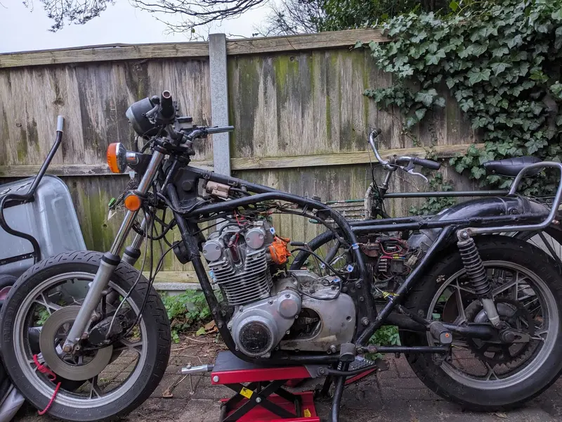

After some hiatus things are moving again. This is the weather to sort the frame out.
The stainless headset cups were a total sod to get out. A mixture of creating grooves in the material with a Dremel and then levering out enough to get a screwdriver sized gap below where the cup meets the heat tube.
Hopefully I never have to do that again! Now the frame and swingarm* is ready to be media blasted for some 2K epoxy primer. I'm going to mask off the VIN sticker to ensure I get to keep it, replacements are available for £20 but instead I intend to paint around, carefully.
*When did 'swinging arm' become the American 'swingarm'? I seem to recall at the start of my motorcycle career in the late 80s it was definitely 'swinging arm'.
