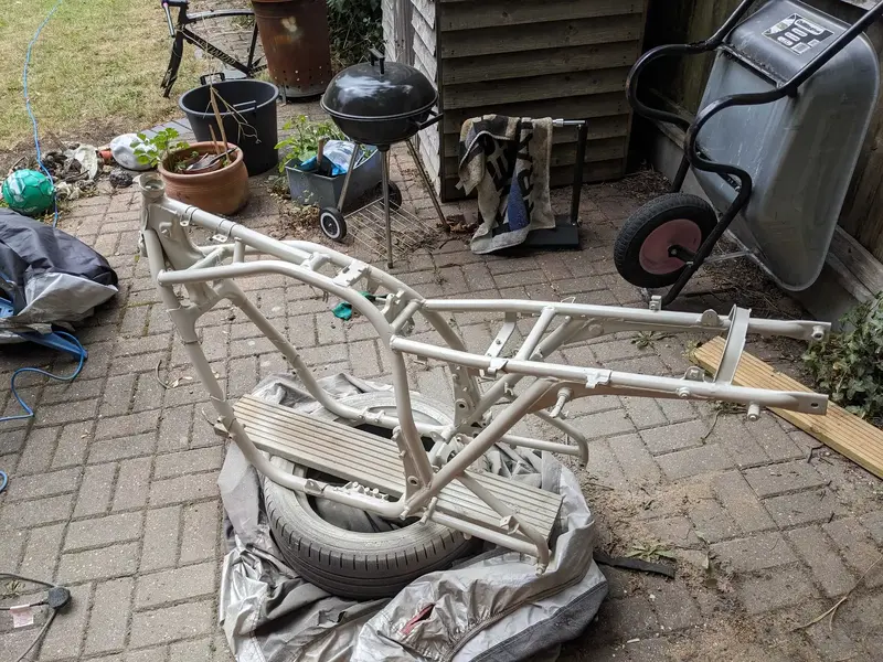

Frame was cleaned back to 1979 by my local blasters who did a great job. The finish is just slightly rough enough for a primer to key into. As I live near the seaside and the weather down here is both showery and windy I didn't want this to sit around and develop too much flash rust - so I got on with it in quite windy conditions today.

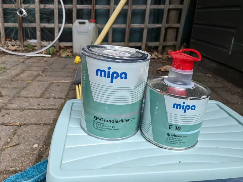

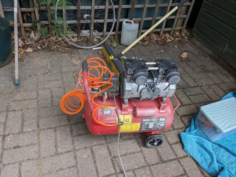

I used 2K rattle cans on my Coventry Eagle respray last summer and opted to go the 2K route for primer. This is a really easy 2K kit to use. 2:1 ratio of primer to hardener, no thining required and sprays at around 30psi with a 9 minute flash off time. Not bad for £23 and more than enough to coat frame, swingarm and brake torque arm (I reckon enough to do x3 bicycle frames in this kit, easily...as long as you had them lined up to go. Once mixed it lasts for around 2 hours so you'd have to be on it. I used the cheapest available Clarke gravity fed gun.
Like I said, bit windy down here so less than ideal conditions. My compressor was christened as a result.

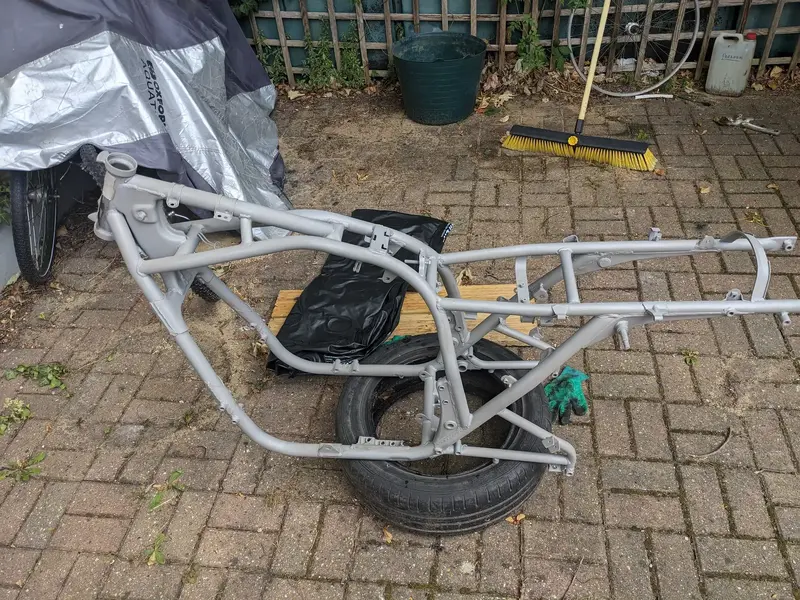

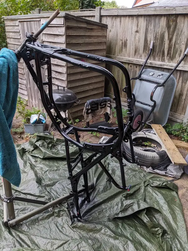

Happy enough with the finish. It was just dry enough for me to manhandle into the shed before it threw down rods of rain, the gods smiled a little at me today. Plenty of bits here to wet sand flat when its all dried out. Still debating on spraying the black chassis paint topcoat or sponge brushing on. There are some pretty functional (ugly) welds that neither paint finish is going to disguise. I suppose its going to depend on the weather and the time window I have - but at least there is something on the bare metal now, so the pressures off.
