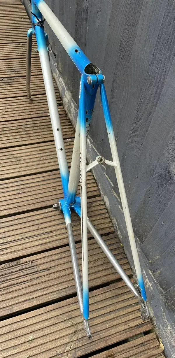

Hey everyone, I'm building up a Columbus framed Olmo with a mix of Campy 9 speed bits. The frame I think is pretty special. I'm trying to identify work out what tubing it is made from to put the correct Columbus sticker on and the model if possible.
The frame is 1940 grams ish and the forks 640 grams. The current sticker that shows which Columbus tube set was used is a replacement used for repaints.
I have only found one other Olmo that's similar on the Internet. This is a link to it. https://www.registrostoricocicli.com/rsc/registro-altre-marche/olmo-005/ It's like my frame with round tubes and the shifter bosses on the side and labelled as having Columbus Air tubes and it features the same chainstays and brake bridge are the same as those fitted to the Columbus Air frames as seen in this link https://www.peterbrueggeman.com/cr/catalogues/olmo-ssn-bike4120-Jaseyjase.pdf I'm thinking it's either a custom Air setup or SL / Air hybrid. I'm certain my forks are Columbus Air forks as I have seen many other Olmos with Air that have the shifters on the top of the down tube with these forks.
There is no ribbing inside the tubes, so no SLX.

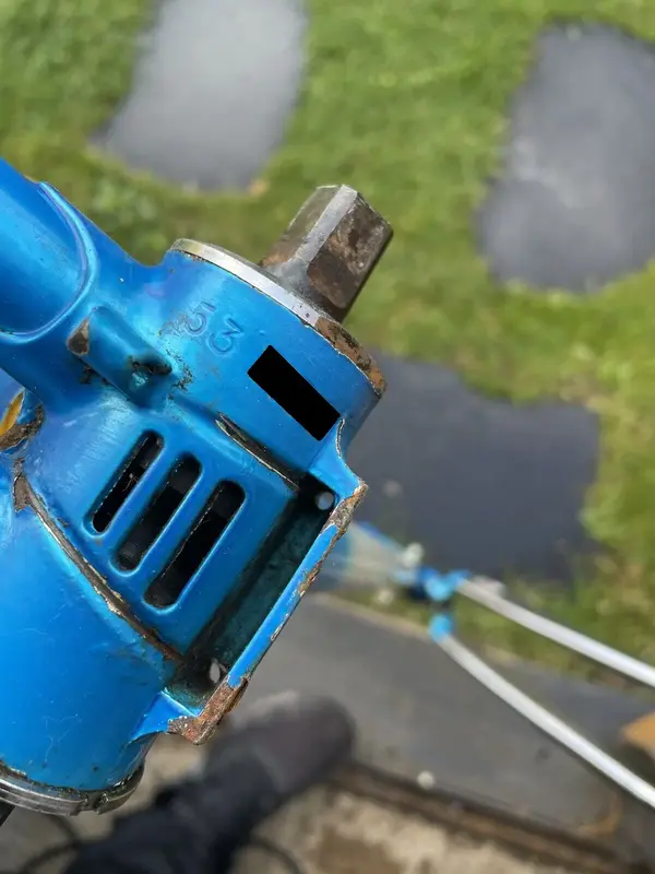

The bottom Bracket is a Cinelli BB. The link below is to the Cinelli steel SuperCorsa which is still in production today. It has the same hidden brake line bosses and the fork crown is very similar though not identical.
Do have any further information on this / views or information on Columbus Air thoughts? Do you know what model this was badged as?
Thanks!

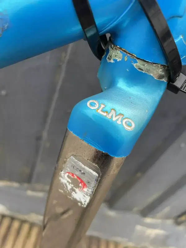

Columbus Air has an ovalised seat tube and a specific seatpost that goes with it. I can’t tell fully from the pics, but yours looks like it’s round. The fork crown looks more like it might be Columbus Max and the deep rear stays also look very Max. If you measure the ODs of the tubes you should be able to confirm this by comparing to the quoted dimensions of the tube set.
Olmo bikes have come back and said Cromor. IMHO I think Cromor iss too heavy to be correct. Looks like a mix to me. I'll do some measuring.
Just checked the weight again after removing the BB. The frame is 1925 grams and the forks 637 grams. The fork weight is commensurate with other Columbus Air forks I've seen and the frame weight is similar to SL.
The main tubes are round and the seat stays are aero shaped. It also has the brake bridge only seen on Columbus Air tubed bikes.
I suspect it was a custom build for a rider. I am relatively convinced I have my answer. Opinions welcome ....... pretty please.
I agree with Johnny the fork and chainstays look more like Max than Air to me.
And that's not a bad thing,.might not be quite as light but rides real nice and they're sought after. Cool bike.

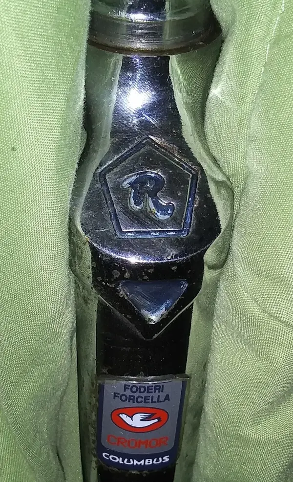

The fork decal looks like the later "CROMOR" style design, so if it is original that helps confirm what Olmo stated. It would also date the frame well after "Air" tubing was presumably phased out (not accounting for possible date errors in the history of the tubing, or old stock in manufacturers' supplies). I would, given the fork decal and the wavy lines on the seat tube Columbus decal (need a better photo of it; not "AIR", "MAX", or "CROMOR" decal, but looks like a "riverniciato"/repainted decal which opens up a can of worms!), date the frame late '80s, and possibly early '90s. My much earlier Olmo has a serial number so I would assume that there would be one on it somewhere that would help nail down the date and possibly the model. I assume the "53" on the BB shell is seat tube size (c-c?).
Head lug design might also narrow it down. Possibly a Prugnat variant?

Photo of my original fork decal (early version).
