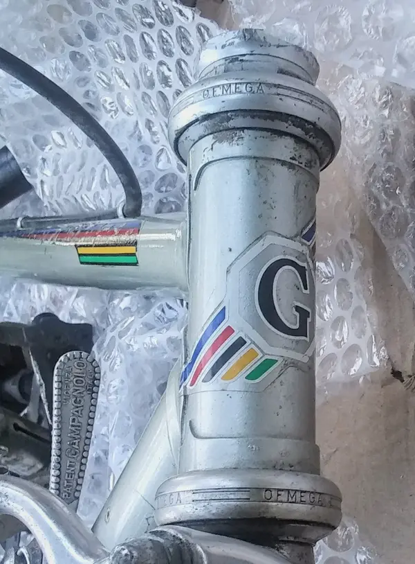

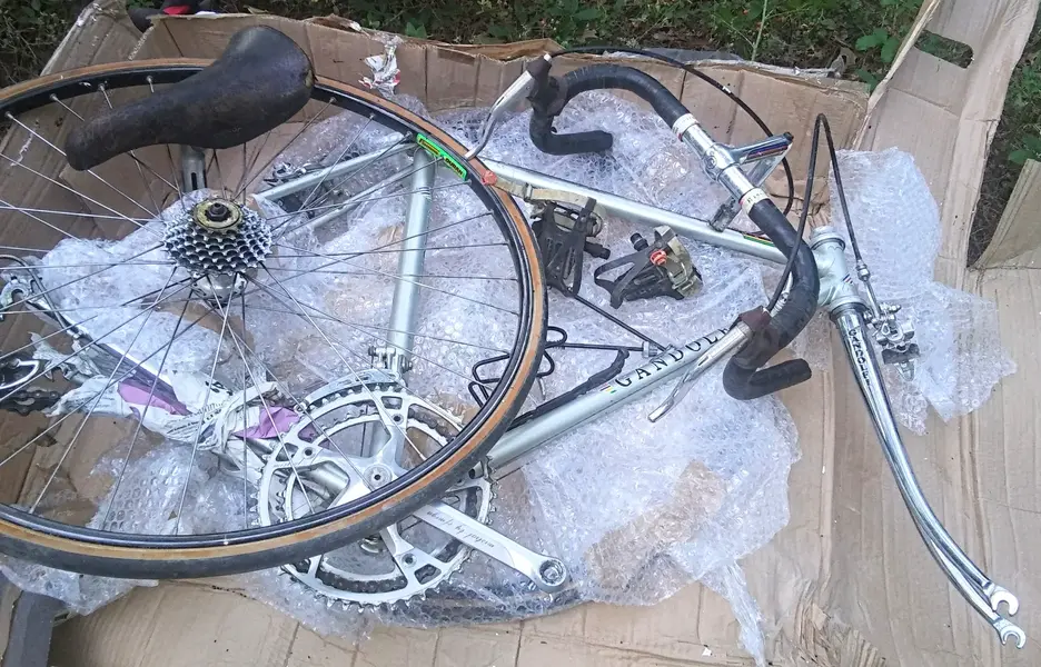

I got this a couple years ago fairlt low cost (I think due to its size) and it got packed, moved around, and buried. No refurbishing done, not even test ridden when first obtained though all components function fine (headset very slightly loose, tires/tubes-holds air).
Gandolfi is a ahop in Brescia Italy that used to sell bikes under their own name, now just other brands. Present staff is not aware if frames were built inhouse or not during the era of this frame. "Super" model; Columbus "SL" frame set w/"house" fork (could be Columbus; but no helical ridges in steerer so not an "SL" steerer or other sets that used the same design)), and a variety of parts. Seat tube 49.5mm c-c/51cm c-t; top tube 52cm c-c, rear fork 128mm. Not sure what was original except stem; but I suspect all the OFMEGA, 3ttt, Campagnolo, and Universal parts are original. Everything included except OE chainring nut/bolt and bar plug missing.
At present:

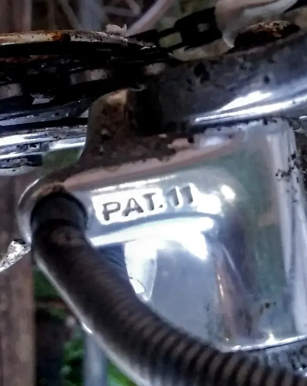

-Campagnolo: Nuovo Record rear mech (PAT. 11, '85); Record front mech (3 hole cage), post (27.2) and shifters (curved & panto'd)

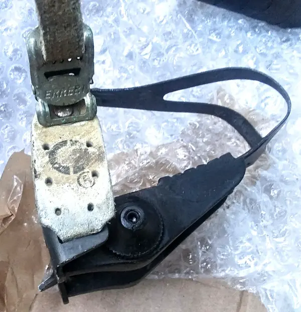

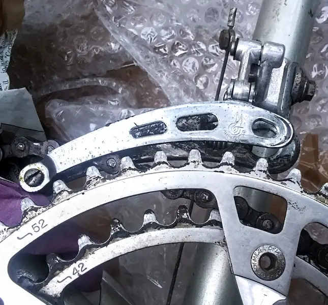

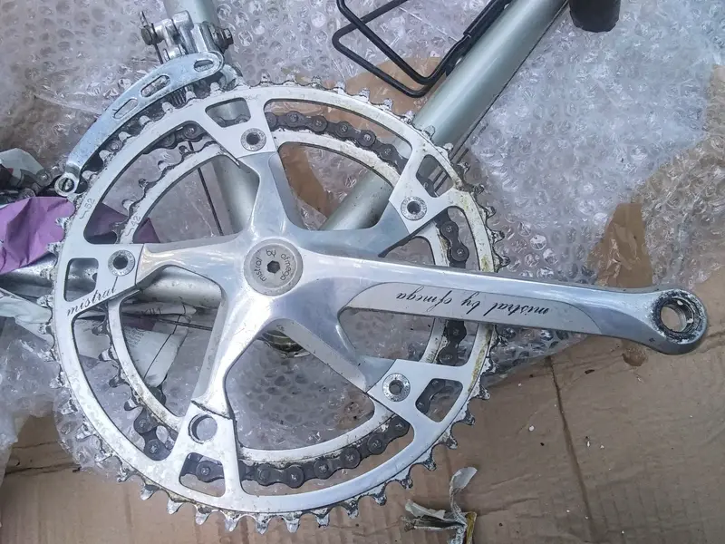

-OFMEGA: Mistral crankset/BB (52/42); Sintesi Pedals; Super Competizione headset; front hub (Gran Premio?);

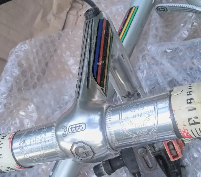

-3ttt: Competizione bar (w/probably original Ribbon tape), Criterium stem (panto'd and milled)

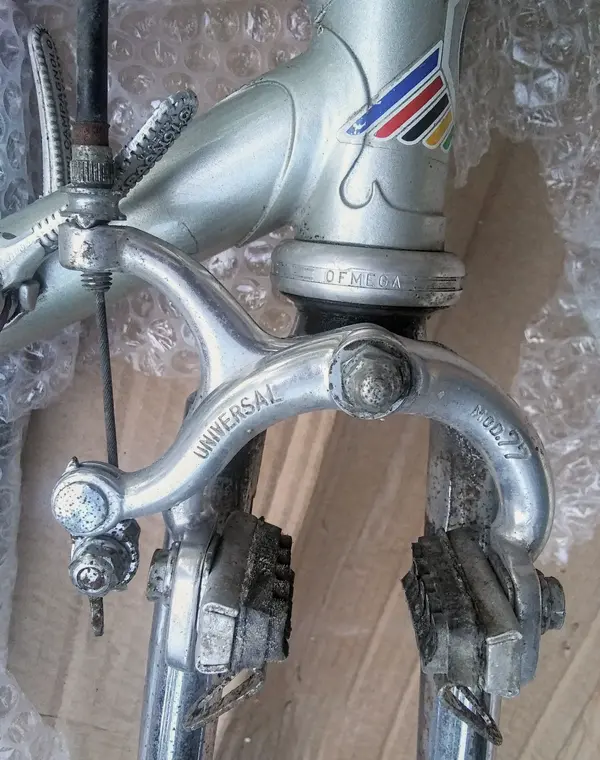

-Universal: Mod. 77 brake set (hoods toast!)

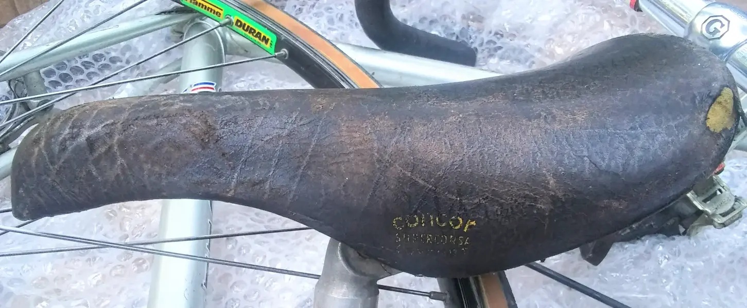

-Concor Super Corsa saddle

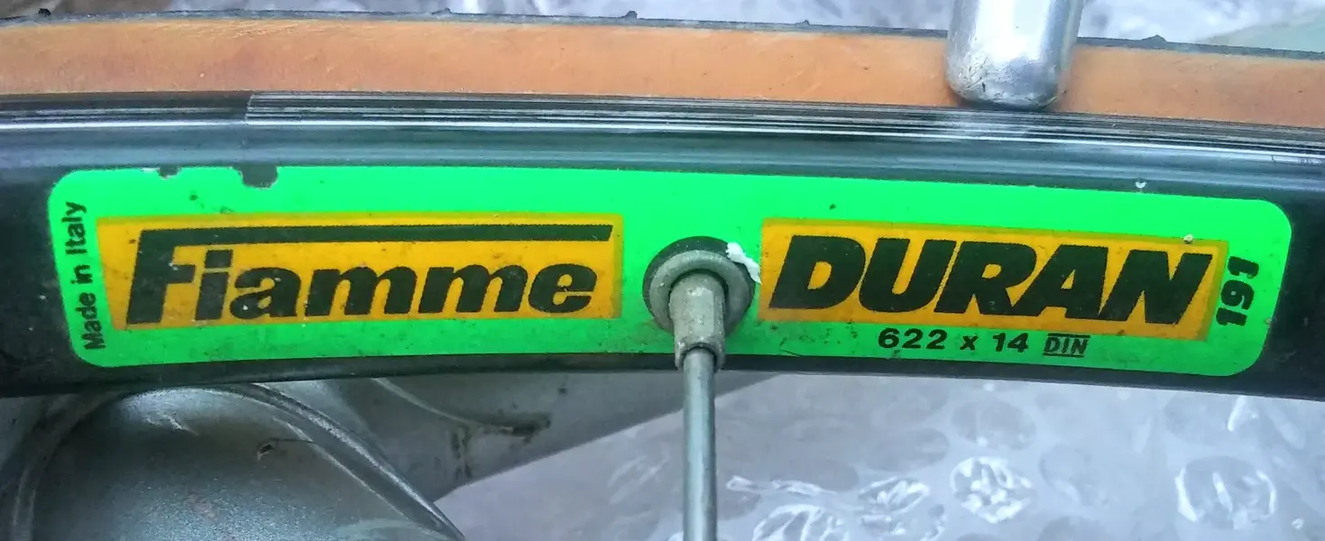

- Fiamme (replacement parts): Duran rims (622x14)

I know nothing about the "Duran" rims. Are they FiR made badged as Fiamme after the buy-out?
I love the pantographing on these old Italian frames. Some super components on this - it should clean/polish up really nice. please show us photos as you restore it!

And nice looking bike, love the panto on the shifters and stem. It could be all original? Atleast the components are from the same period.

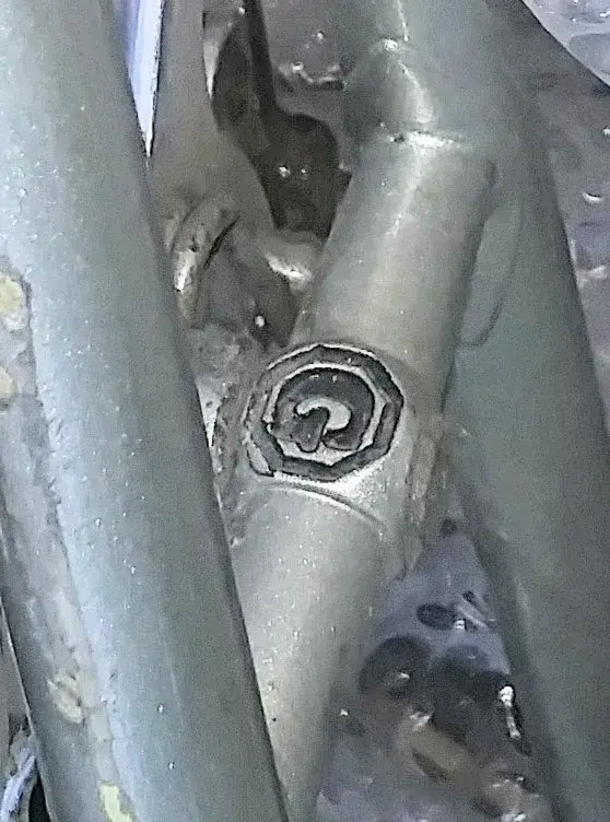

The clover leaf (3 & 4) have been used by various marques in various countries, but the Santini frames sold by the Cicli Santini (Ermanno Santini founder 1960) shop in Forte dei Marmi has (had?) the 4 leaf clover with curved stem and had a "4 leaf" type cut-out drain in the BB shell (apparently hand drilled by the maker, as they are not consistently cut). I know they sold bikes with Santini branding through the 80s, but not sure how much esrlier or later than that era. The frames with the odd cut-out were made by Gino Vanni (not to be confused with "Vanni" Losa who was an independent builder whose frames are highly sought after and found under many marques in many countries); a small builder from Migliarino Pisano, Vecchiano, Pisa. If just the 4 leaf clover in the lugs and no custom BB shell cut-out (BMZ used fairly common BB shells; solid, slotted, etc.; but no fancy designs) then it sounds like it could be a BMZ frame (they built for many shop brands). The BMZ stamp on the BB shell might be obscured by paint if it is one of their products. Trying to remember other brands with clovers, but not clicking except a name beginning with "M" (Milano, Mondial, etc. something along those lines). I need to check my notes regarding different marques using similar logos.
My clover leaf frame has no stem (look at my icon image), Lusa/Lusatti marque. Also similar (or the same) is Tomi which had 4 leaves with no stem, and who is presumed, after research, to be the builder of my frame as his logo was turned differently in aspect than all others and I can find no other design to match. Tomi also built under his own marque, and also for Cinelli.
