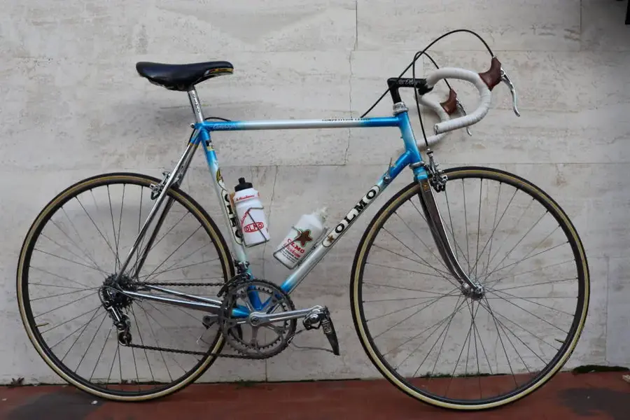

Olmo Columbus Air?
Columbus Air has an ovalised seat tube and a specific seatpost that goes with it. I can’t tell fully from the pics, but yours looks like it’s round. The fork crown looks more like it might be Columbus Max and the deep rear stays also look very Max. If you measure the ODs of the tubes you should be able to confirm this by comparing to the quoted dimensions of the tube set.
See my previous comment about "AIR" seat tubes. 2 designs were used.
Jesper, thanks for the reply. Mine is a repaint. The down and seat tube are round. The seat stays are aero. The blue one is the only one I've found on the Internet with the same BB, lugs, rear brake bridge, fork crown and colour scheme is pictured. The only difference is the seat stays are chrome. Mine even has the same colour panto paint under the white on mine. The bike is stickered as Air, but I think that applies to the forks and stays only. The Brown one is looks as if it has regular SL stickers. Cromor has a stated tube weight of 2190g vs 1925g on SL. 265g difference. My overall frame weight of 2562, is commensurate with SL allowing for crown, BB lugs etc.

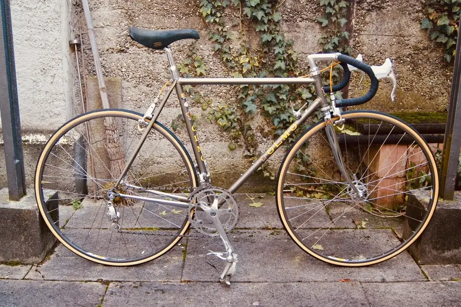

I think Cromor forks being chromoly are the same as air. Weight seems similar. I'll sticker mine similarly. IMG_00001.webp olmo-leader-c-record-6364_107.webp
@AJ 1967 thanks for the comparisons. Unfortunately, I do not have an Olmo of that vintage; mine is c. 1978-'80. It is very difficult to judge by weight given that your frame is on the smaller side for sizing. I am pretty certain that the weights referenced were for a larger frame size (56cm?) and I know the weights were based on a raw uncut tubing set; even a larger frame might appear lighter depending on the final cut lengths of the tubes, and lugset/BB shell used. The fork crown is definitely of the same design I have used before, but again if the decals for the blades are original than "CROMOR" is quite plausible. I have seen other Olmo frames using "CROMOR" so it was not something alien to the company in its manufacture of different mid range models. "CROMOR" & "SL" both take 27.2mm posts as both seat tubes are drawn to .6mm wall thickness at the top, but "SL" has .9mm thickness at the butt, and "CROMOR" is 1.0mm at the butt (https://www.columbus1919.com/en/seat-tubes-2/).
I would suspect a "CROMOR" frame if no reinforcements (5 helical ridges) in the steerer tube, whereas "SL" frames had fork steerers with the ridges.
Olmo was known for making a wide range of bikes to meet certain price points so I am not surprised that they made an entry/mid level TT style frame during that era.
Regardless, it is a great frame. I liked my Olmo and I think it was "Aelle" tubing (or "SP") so definitely an entry-mid level and had the top of the line Galli components (as good as Campagnolo, and lighter weight).
Hey Jesper, you have pushed me to look harder at the Cromor option and I think I've found the evidence to rule that out. The Olmo Cromor frame was sold as the San Remo frame or Firenze Bike. It had round seat stays cheaper lugs and bottom bracket. So i'm confident it's not that. From a thread on Bike Forums it also had dual water bosses and a pump peg. I found a San Remo 53 cm for sale at that says it's 2.69Kg v 2.56 for mine. I suspect the Air fork is the same as the Cromor as those that I've found on line have the same weight and are both made of CroMo.
I'm now relatively convinced I have a Air / SL mix. Not that it matters much as Cromor is supposed to be almost as good as SL and the difference would be imperceptible to me. Do you know where I can find a 1985 SL datasheet with the tube profiles on it?

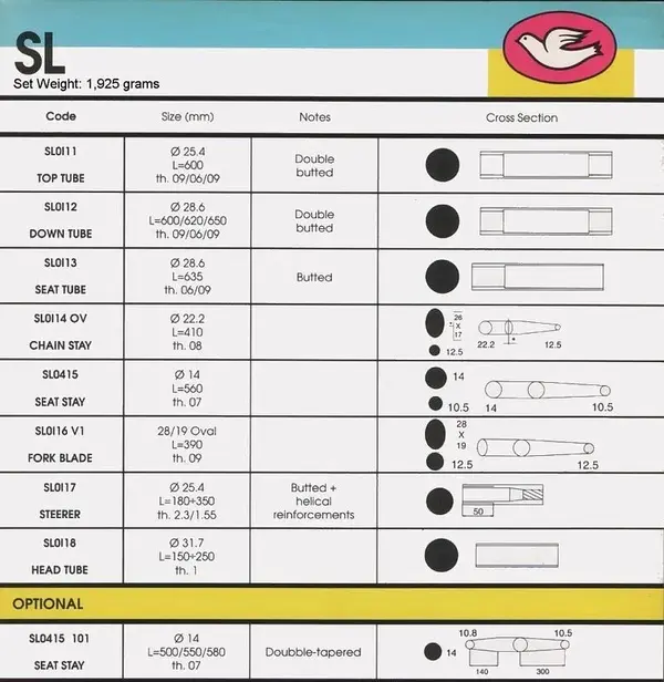

@AJ 1967 here is an "SL" chart I have, not sure of the year; but it is that general period given the single wing dove logo and spec'd weight. I would certainly check the steerer tube for the reinforcement ridges. I think that would tell you that it is "Air/SL" since the "CROMOR" steerer did not utilize those helical ridges (except possibly as an odd variant, as later explained).

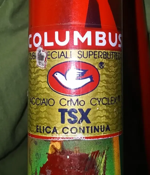

I have a "TSX" (their top of the line when introduced) frame that is the seamless tube like "SL" & "SLX" using the same "Cyclex" CrMo alloy, but Columbus also made a seamed "CROMOR" version of "TSX" also. It shows how willing they were to use unique features of one tube (full length helical reinforcing on "TSX") and incorporate into a slightly lower priced tube. That is another reason why there is a possibility that you have a "CROMOR" tubed frame that has the outward festures of "SL" and/or "AIR" tubes. Columbus did not make it easy on buyers; and the builders were able to use unique tubes to build models of a certain type of frame that would meet different price points for the buyers. Not much different than Campagnolo making the same version of the "Record" front derailleur, but having anodized a couple pieces black and calling it "Super Record" to sell at a higher price while it performed and weighed the same as the less expensive unit. It is all about marketing and giving buyers options to fit their wallets. As I have firm proof that the "CROMOR" can be shaped to the same degree as the "GILCO S4" tubing, and like "CROMOR" can be reinforced the same as the "TSX" tubing makes it difficult to differentiate after the fact what a specific builder did or did not do when making their models. I still would not get to hung up on weight, it one of the least accurate means to identify a bike's actual tubeset unless you have an identical frame size with identical fittings, paint and chrome, and weighed on the same scale. At least you can be sure that you have a quality lightweight frame that should perform excellently when built uo regardles of what decals get put on it. I have frames that I have never been able to identify the tubing on. It most likely is "SL", but no way to tell for sure given other tube makers copied tube profiles just like builders copied frame geometries.

"SL" '80s ("SL" used to be spec'd heavier [2065g] in earlier catalogs and that is how I know that this is appropriate to the era of your frame. Weight was reduced from earlier tubeset version due to shorter butt lengths)

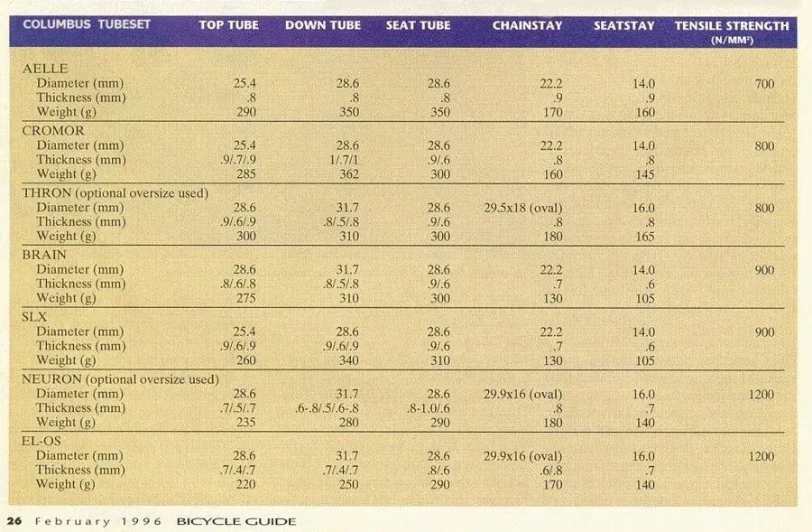

From Feb. 1996 "Bicycle Guide" mag.; shows "CROMOR", but not "SL"

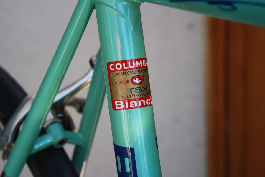

"TSX", and "TSX/CROMOR"
