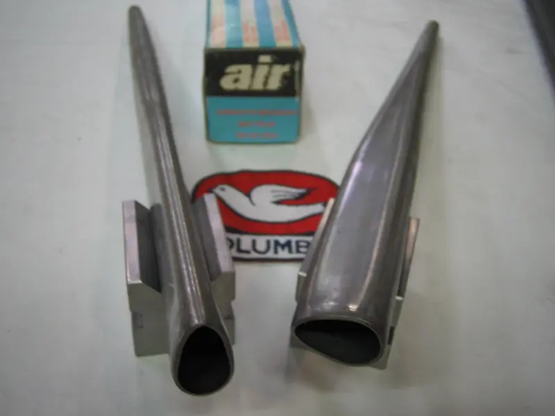

I got this photo forwarded to me from a friend who states that it is the crown from a boxed set of "AIR" lugs and tubes. He was told that Columbus did not make the crowns themselves, but they were IC crowns made (contracted) to fit the particular shape of the "AIR" fork blades. Pretty obvious teardrop design, so rear of the blade would be quite narrow compared to the front. I cannot discern dimensions from your photos, but I am sure that you would be able to tell with the fork at hand. Original teardrop seat post along side.

columbus_air_seatpost_crown_showing_teardrop_cross_section_d2a7b78d4b6420428ee8730a835291c6996...jpg
Air Blades (before bending)

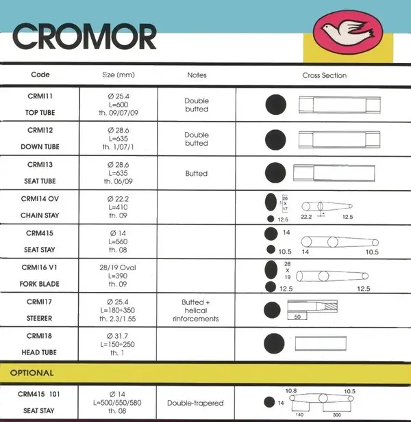

Cromor was a tubeset for the budget conscious buyer, I don't think you would go the extra mile to reprofile tubes, a builder wouldn't waste their time doing this, let alone a manufacturer like Olmo, the catchet of a better tube set would sell better. I also think it's not young enough to be of that era.

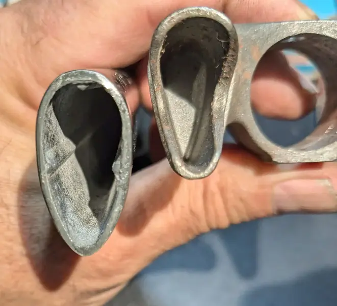

That crown is really interesting my forks are the same. I compared the measurement of the wider section of the fork blade on the crown (front) to the rear and its the same ratio on mine. The Cromor forks fitted to the Olmo San Remo (Cromor equiped bike) are oval. My forks and seat stays look like all the other Olmo Air equipped bikes, so that I think is now beyond question. The weight says it has to be SL for the frame. I came across a quote "An SL or SP tretubi frame will use a 27.2mm or 27.0mm post but not have the ridges in the steerer." So that addresses the lack of ridges in my steerer tube. IMHO it should be stickered as Air as the factory did for these frames, but also could be stickered TreTubi with AIR fork stickers.
