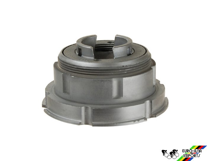

Blimey my memory is bad but I don't think that's a locking on the underside just part of the outer part of the body that holds the cogs and spins around the bit that screws onto the hub.
