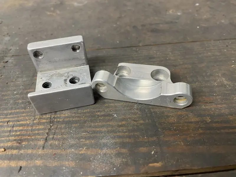

I’ve literally just removed my Spooky mount/ Hope mount ready to take to my friends CNC shop next week (see my other thread) as part of a batch of rare items to have reproduced

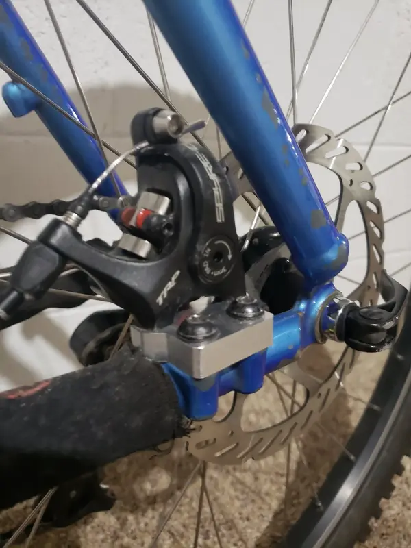

Ive actually designed and produced one that adapts the usage of the 34mm flat mount brake calipers. Its currently going through a slimming process/revision to fit smaller frames.
I have this one mounted to my Klein Attitude Comp, and another one (ver 2.0) going onto my small frame trek 6500.

That's neat. I think I've seen these mounts on Trek VRX bikes too, nice to keep the options open for fitting new calipers.

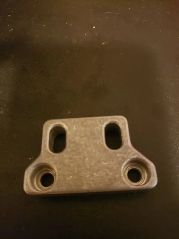

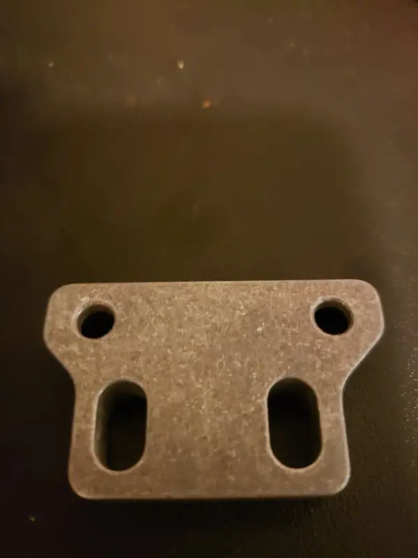

Did you ever get one of these adapters with a flat mount on your spooky?
I did. I bought one from a chap in the US called Eric. He is on the Bonus Tomato website. He had a load 3d printed in steel. Worked a treat with a flatmount caliper on my old Pitboss. It's in storage at the mo otherwise i'd send you a picture.
