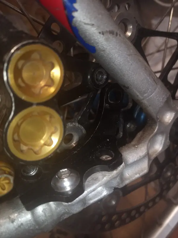

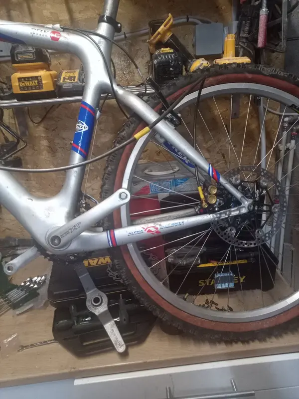

Keyword SOME Klein, Trek (Trek owned companies basically). Admittedly, I´ve only tried it on my Elite 9.8, but it doesn´t fit.
the rear mounting point fouls the seat stay, it has just occurred to that it might on a bigger frame, for a giraffe maybe, where the angle between the stays is bigger it might not be an issue.
So if, like me, you own a late 90´s Trek etc and saw these and thought "ooh! ooh! ooh!" seeing an opportunity to fit, say Hope mini monos or M4, to your steed, disappointingly not I´m afraid.
*edit* In the minutes since writing this I´ve realised that due to the design of the oclv frame, the rear triangle is quite small and if t was a smidge larger then the adapter would probably clear the seat stay. Damnit!

Although the frame measures 44cm, medium?, the rear triangle is quite small. If the seat stays joined the seat tube a bit higher the adapter would probably clear it. Damnit!
So if yours is a conventional designed frame that isn't tiny sized, these will probably work great.
I'll be in the corner with a file if anyone wants me.......

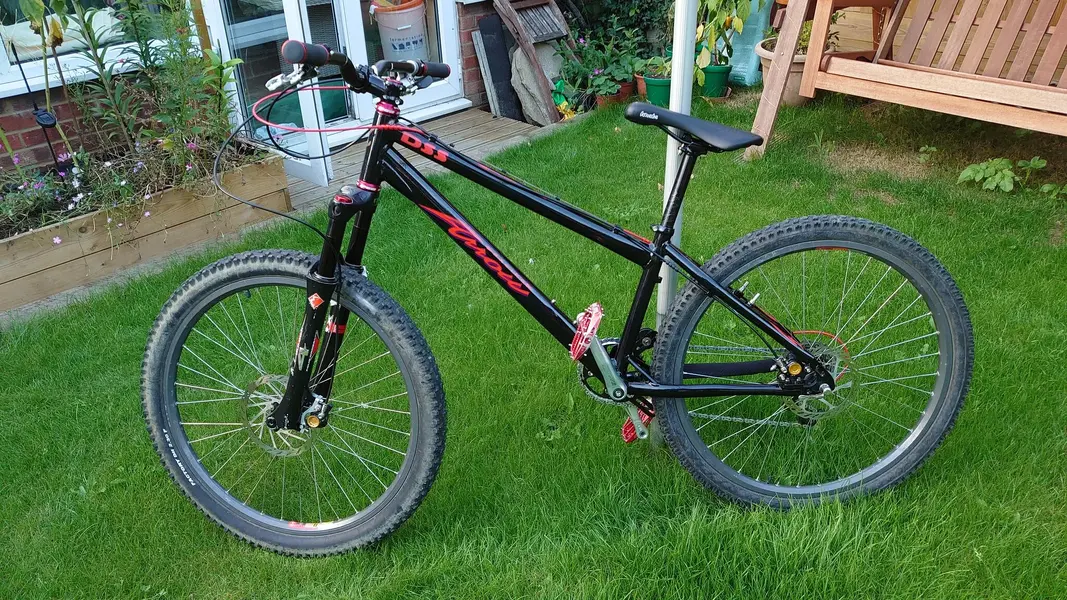

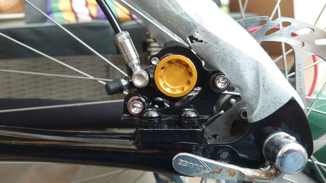

I have one of those on a small jump bike. It fits but is quite close.
On your OCLV it looks like the seat stay joins the chainstay forward of the dropout which reduces the clearance. On my bike the seat stay joins to the top of the dropout.
