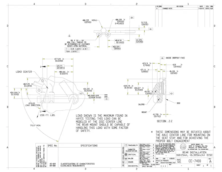

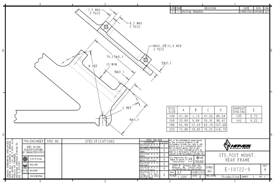

Here are the standard dimensions.
You should be able to combine them into a Hayes/Post Mount adapter and work around your seatstays in the middle.
Hayes 22mm standard
ISO Rear Post mount

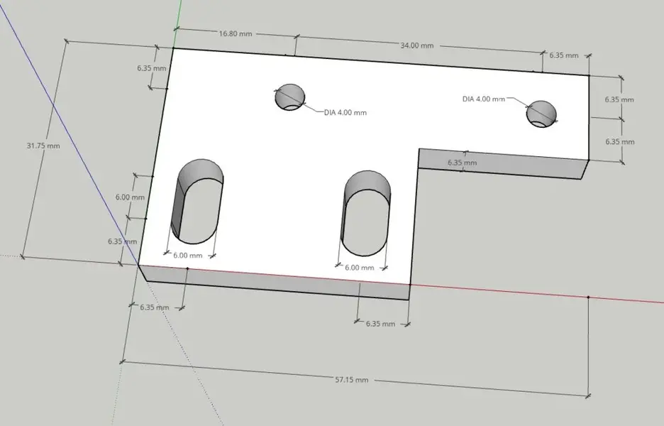

I do have my hopes set on a Hope Tech 3 E4 set-up in the rear to match the front and thus the post mounting configuration is the target; however I have set my sights on Hope's X2 Flat Mount as the contingent approach. As you indicated, the X2 is likely the easier route but the URT geometry is rather tight. I guess I will begin a little design effort and see what can be packaged and where.
