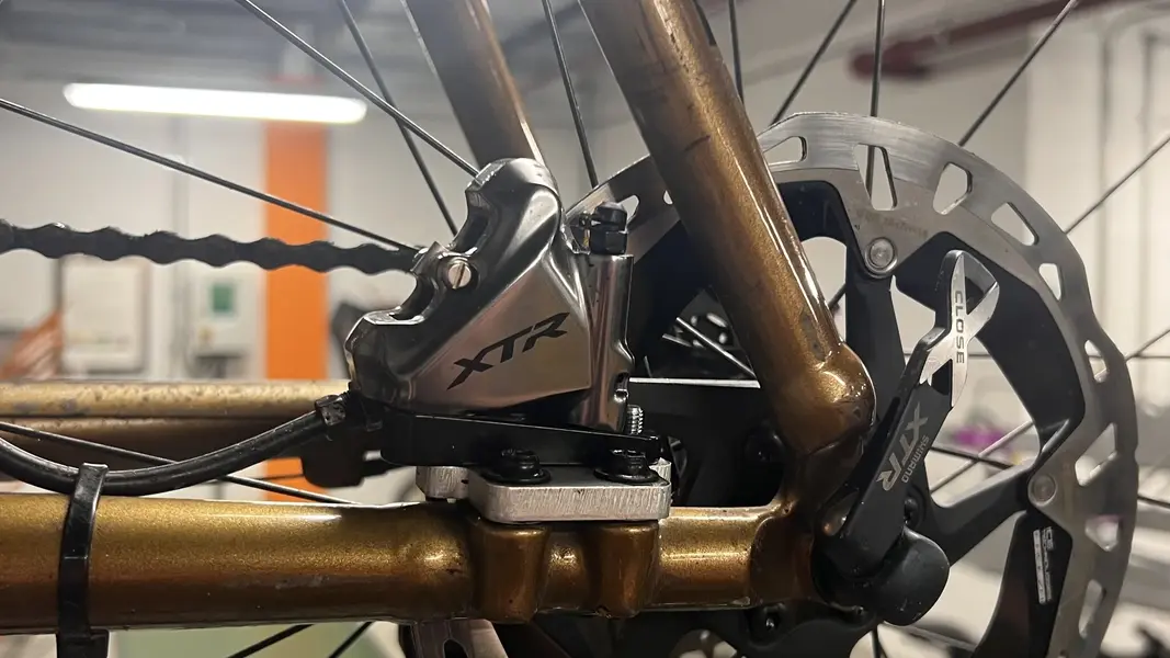

I finally got round to having Mr Orange’s adapter fitted to my 2001 Klein Attitude Comp and it’s working great!
Used a M9000 XTR flat mount caliper and an Elvedes 15378 flat mount adapter to raise it up a few mm to work with the 180mm XTR RT-MT905 rotor
Routed the hydraulic line through the top tube internal routing and cable tied to the seatstay which was the neatest way we could find
It’s all working perfectly and I can finally ditch the old pressed steel adapter I’ve been struggling with for 10 years!
Massive thanks to @Mr. Orange for all your help!

@andyfettes Nice work, very cool bike, As far as I can see from the picture.
No thanks for the assistance; my pleasure.
Glad to hear that the adapterplate works good.

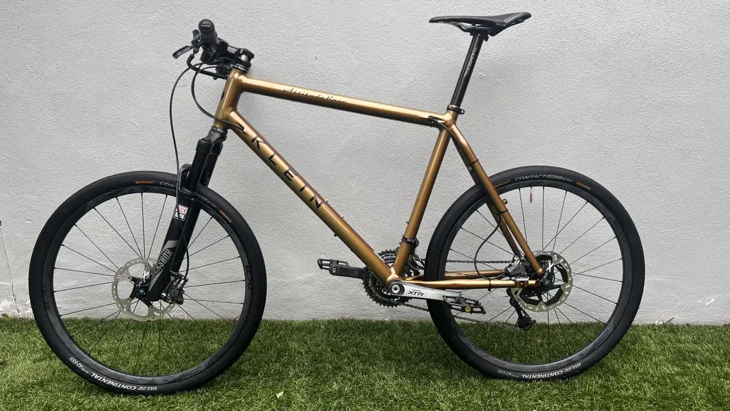

Here is a picture of the whole bike with the new brakes!
Finally got it down under 10kg after removing the old steel adapter which was over 200g on its own.. 9.85Kg now!
