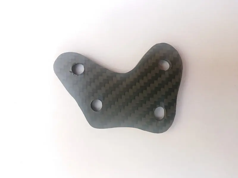

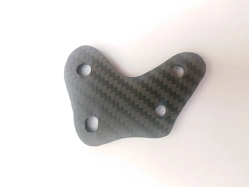

i have made a couple rear disc mounts from 3k 5mm carbon to fit my Marin east peak year 2000 ish so i can run disc brake- see pictures
you can't seem to buy this mount which is why i made my own
its hand made using Dremel so a little rough around the edges, not cnc machine quality but it fits perfect

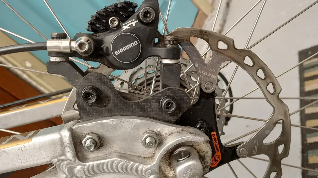

my set up on bike as i made this mount is as follows
shimano xt m785 disc calliper with shimano xt 180mm rear disc rotor and 180mm shimano is to post mount
if you run a smaller rotor like 160mm then obviously you will use 160mm is to post mount

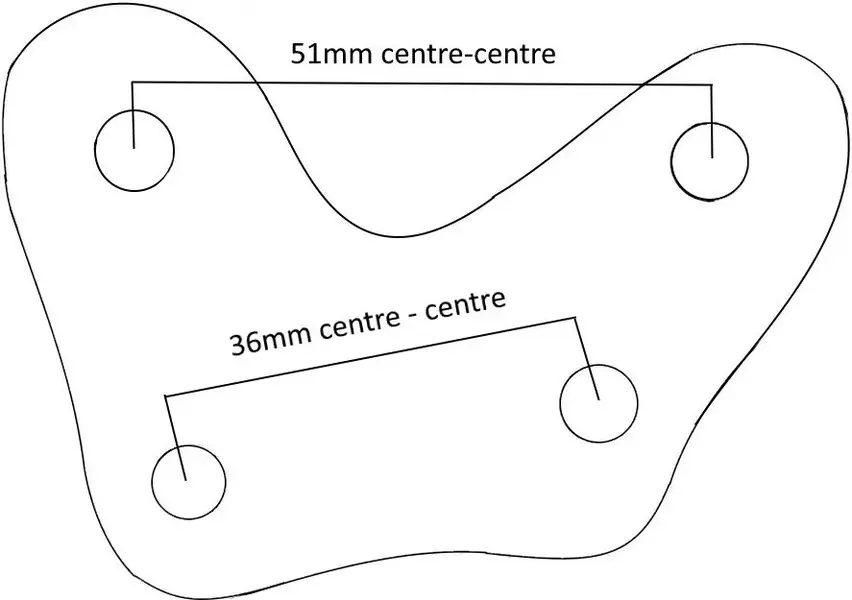

frame bolt holes centre to centre - 36mm
