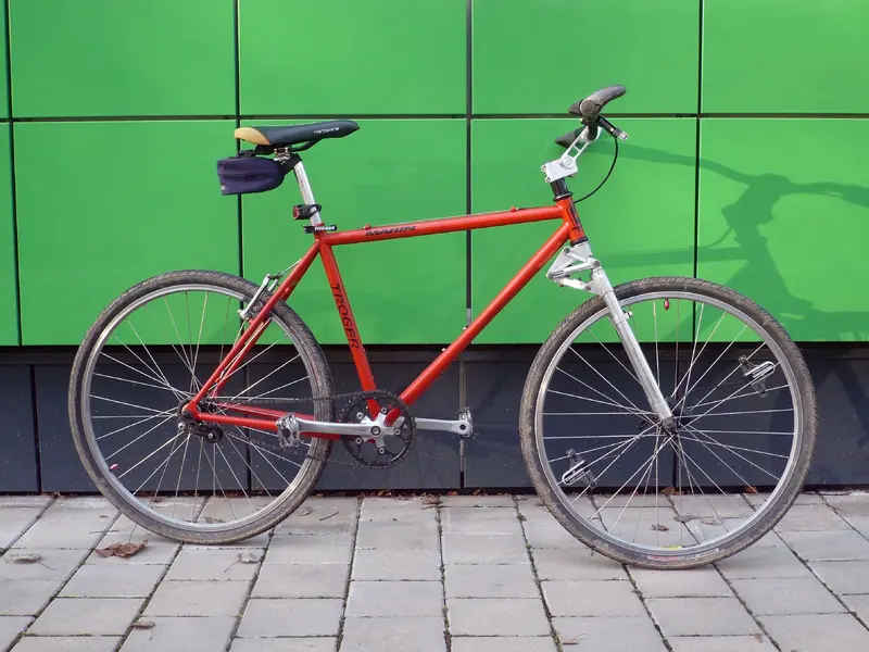

This is my urban bike, on a Troger Crazee Edelweiss frame (columbus thron tubes). Conformal but also fast when needed.

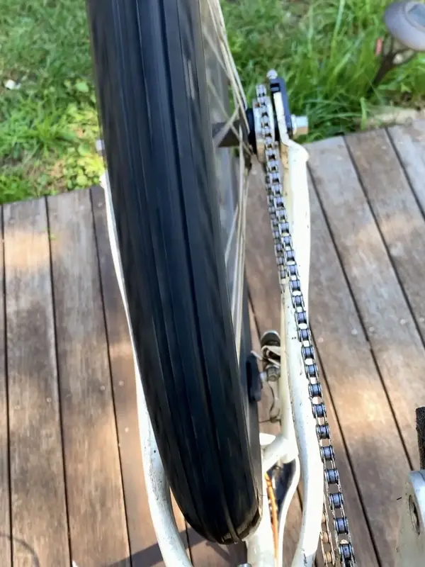

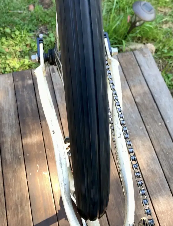

Hello singlespeed gurus -- looking for advice on the alignment of my drivetrain. I've been quite happy with the bike but was giving it a lube today and saw that the rear wheel, while running straight, is positioned too far to the left (see pics).
Does this affect the ride -- or should it be properly centred? The only way I can see that happening is if the wheel is re-dished -- is that right? (Apologies for the dirty state of the bike btw!)
