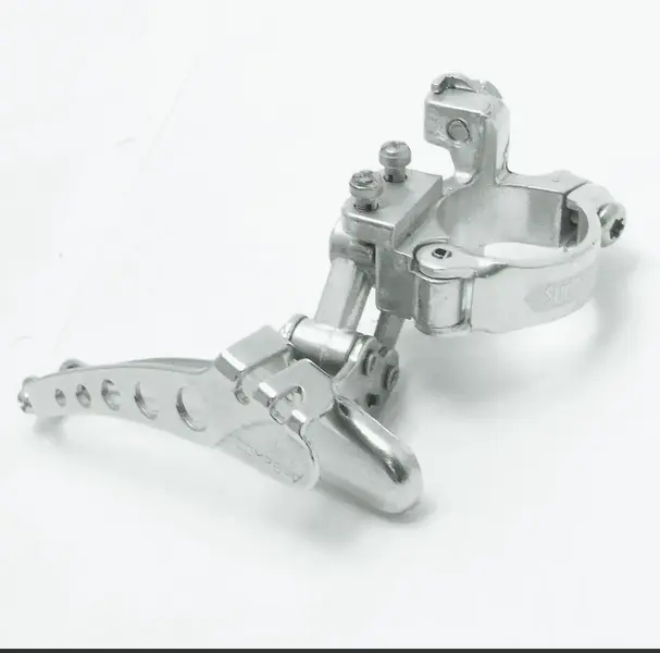

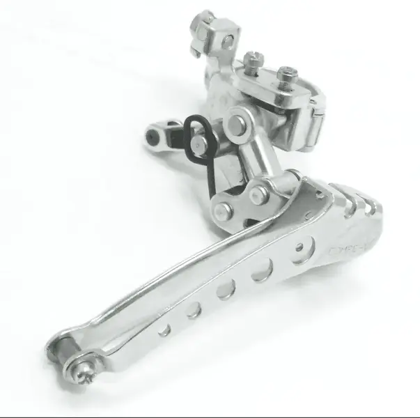

Re. the Comp V front mech, be aware that it's default rest position is on the outer chain ring so you pull on the lever to drop onto the smaller chain ring. The earlier Spirt mech from Sun Tour was the same.
