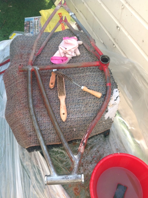

I finally got/took the time to begin stripping the frame.
First with some rust remover and then with paint remover.
The paint is pretty tough, the frame underneath is in very good shape.
Unfortunately the rust has left a lot of small pits which I can't remove with sanding.
They are very superficial, but will show when painted.
So I guess I have to use some filler...
