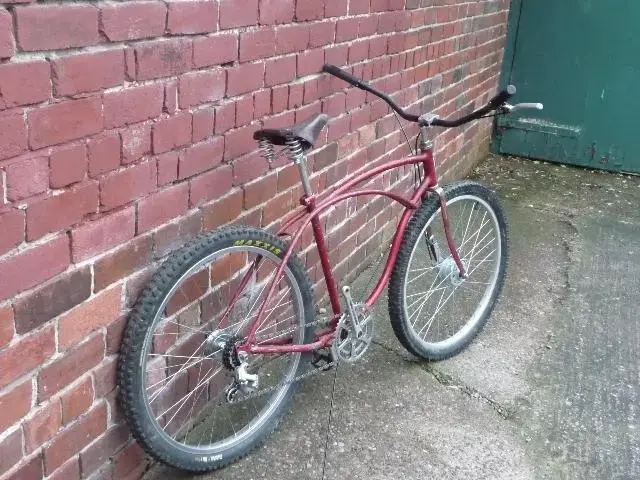

Re: Schwinn DX '40 Clunker [need help page 5]
Done it, a lot of hassle getting the bits together,but worth it,looks more speedway than Klunker,will be a bit of a rolling test bed for the pre war frames i have in line
