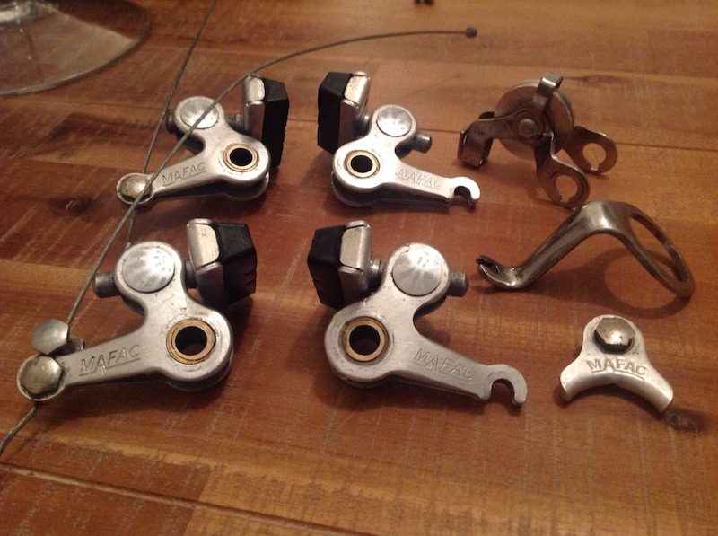

Well, the canti's are sorted and on their way.
I found a very nice pair of Mafacs on the local marketplace.
And the handlebars too, found a pair of Honda CB200.
Now I have to decide which way to go with mounting the canti's.
My favourite option are the Moots mounts, but they are very hard to find.
There is no substitute for those that I know off, except for making them myself.
Another option is brazing bosses, I would love o learn that.
What way would you guys go or are there other ways?

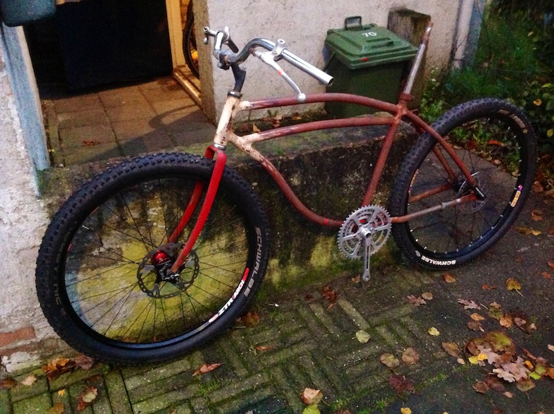

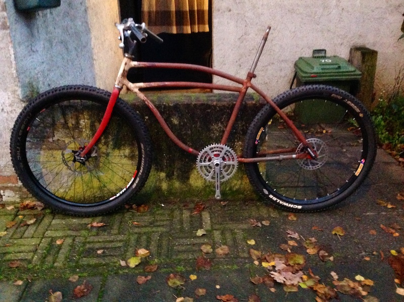

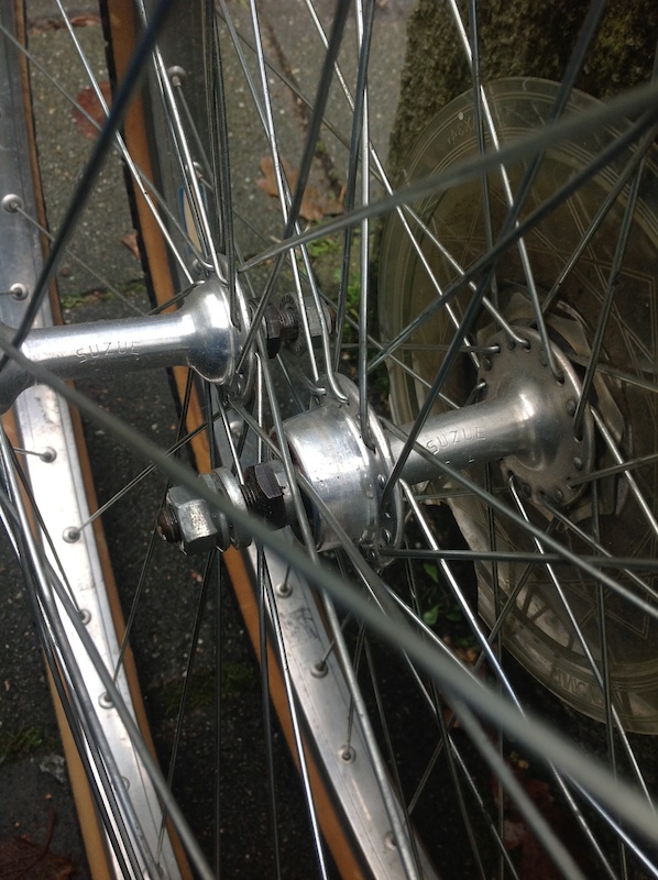

Yesterday I recieved the Mafacs and the handlebars.
I couldn't wqot for all the parts to aarive wo had to put a few parts on the frame to get an idea of how it would look.

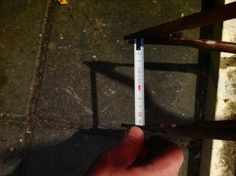

I used some wheels of my other bikes because my wheelset is still on its way. It had to be two front wheels, as the spacing is offcourse to narrow for a 135mm wheel.

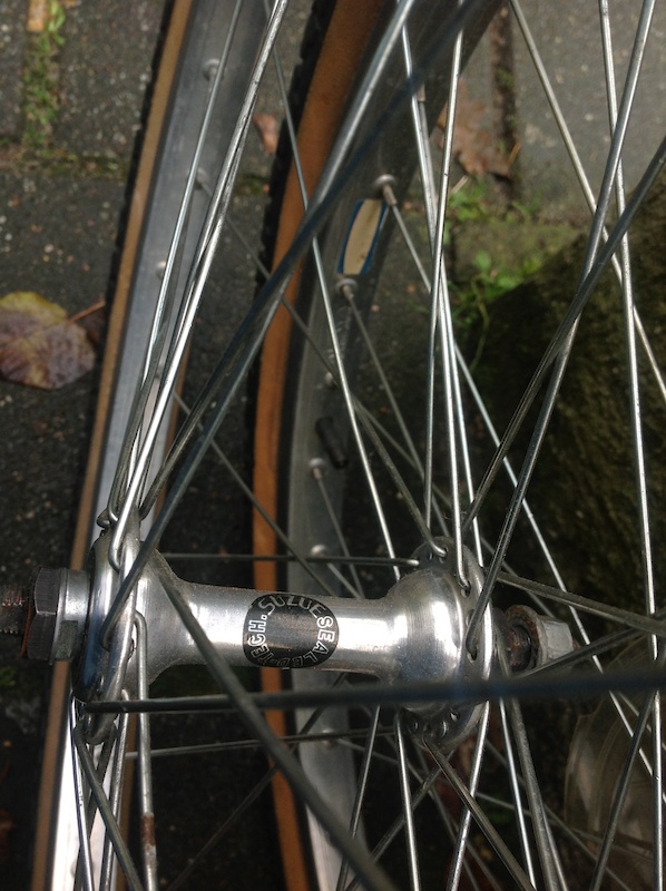

I recieved my wheelset yesterday, very happy with it!
It looks like it hasn't been used for more than a few hundred miles.
The rims are perfect, cogs barely used and hubs with decals sin smootly.
Just need to clean it up a little and replace the rim decals I allready ordered.

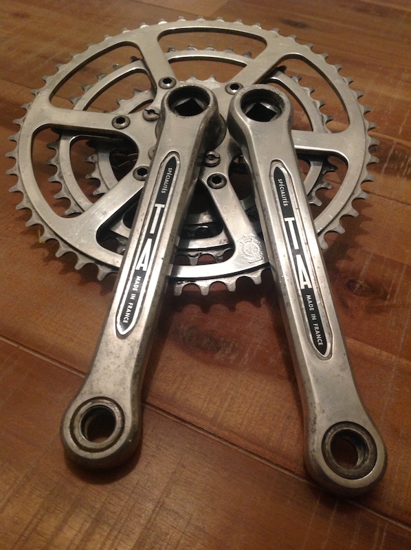

I gave the other parts a good clean, I might polish some part to get it a little more shiny.
The cranks sure need some more polishing or even sanding.

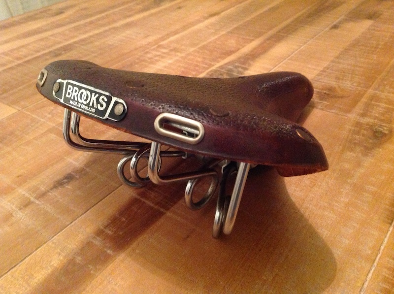

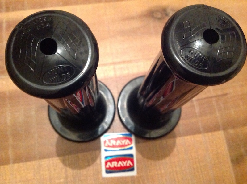

A few new parts arrived today, Hunt Wilde remakes, Araya decals and a Brooks B72 in mint condition.
