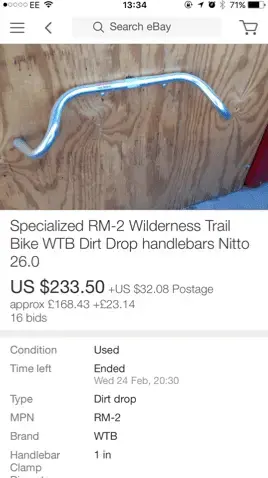

Good points. Humm. Been a lot of interest in drop bar set ups on FB recently, which is not helping prices :facepalm: A set of WTBs sold for nearly £170 last week...fuxx that with shipping and import.

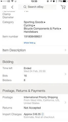

Do you have a link to that auction?
Rampage":2fsuvrih said:
M-Power":2fsuvrih said:
legrandefromage":2fsuvrih said:
Bear in mind aluminium doesnt 'just snap', its inert until stress has been applied. This changes the composition of the material, the grain and so on - this can be riding everyday so if you were to do it, I'd use new or unused bars.
Item number is on there. Crazy price with shipping and import on top :shock:
