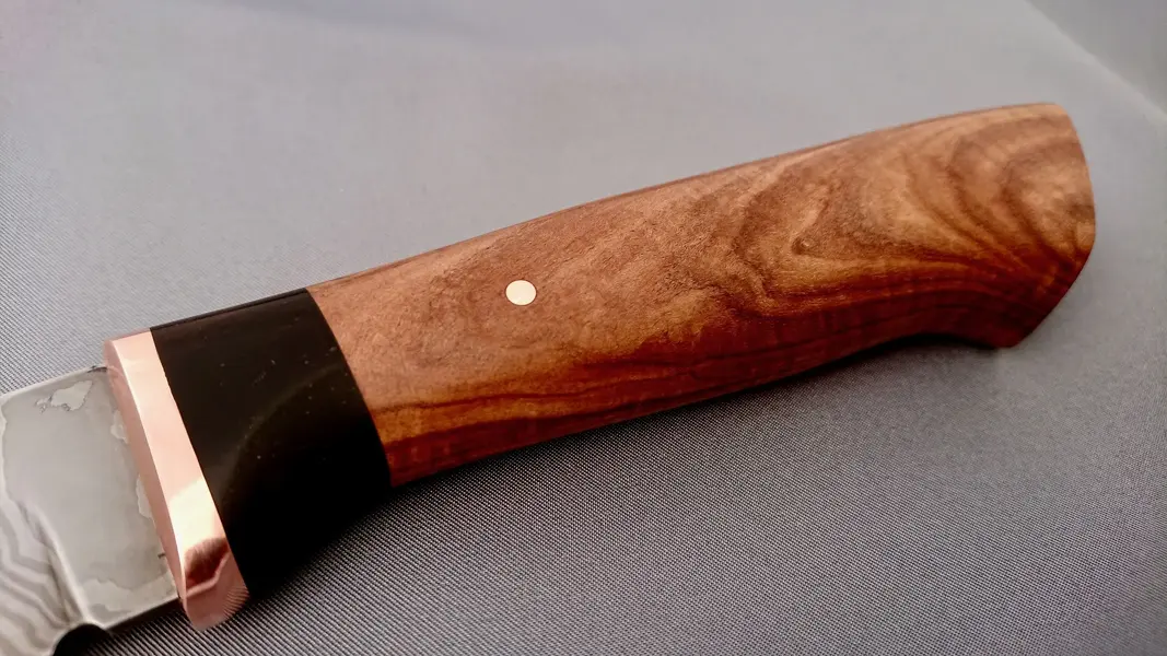

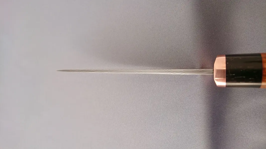

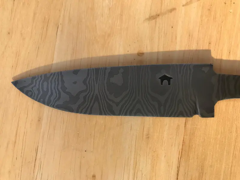

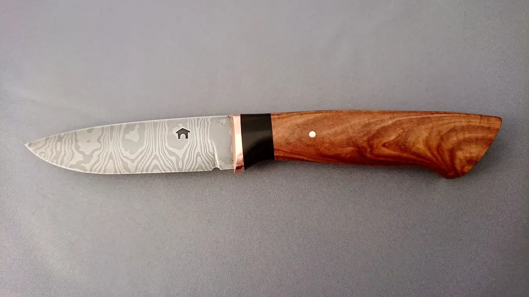

I said a few posts ago that I hadn't made my mind up on the handle for this one;
As it turns out the decision came quickly and easily. I've had a bit of very old Oak set aside for something special for a while - my dog brought the Oak piece home from the forest with him one day, he'd been carrying it for about an hour. I'm guessing it'd been sat there for a very long time as whilst the outside was extremely weathered and rotten, the inside was incredibly dense, dry and rock hard. I'd been working on that blade in the days before he passed away.
So I've spent a 'few' hours this week finishing it off. It's 15n20/1080 ladder damascus, the blade is 4" long, and 2.5mm thick. 9" total length. Copper pin and bolster, African Blackwood and Oak handle (Blackwood courtesy of Dyna-Ti; thanks matey!).
It's the best I've made yet, I think. The photos don't quite show off the depth and pattern of the wood.
Hope you all like.

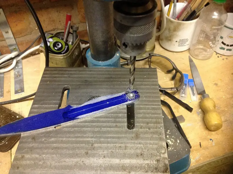

Here's the start of one I'm currently making.
The steel is 4mm thick O1 tool steel. The design is a slight alteration of a standard bushcraft clone. Handle is slightly slimmer with the usual 8mm pins dropped to 6mm. Lanyard hole will stay at 8mm.
Next stage is to cut out the template and transfer the design onto the inked up steel.

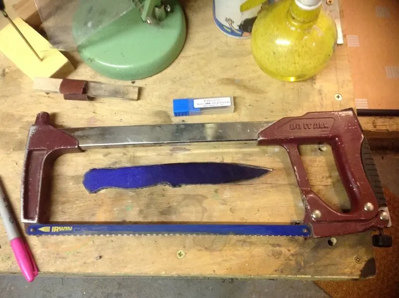

@My_Teenage_Self yes, lots of filing and sanding. Next stage is to cut out the blank.
Hacksaw is the weapon of choice. Depending on the weather, time and how lucky I'm feeling, I might use the Angry Grinder at this point. The 1mm cutting discs turn a DIY grinder into a useful cutting tool. Lots of vertical lines and then join them up with a cut.

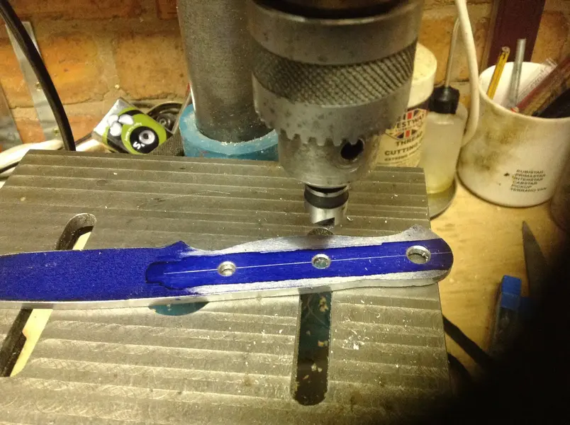

Over to power tools for the drilling:
I use a hand reamer to get it to the proper size and then take the edge off the holes:
