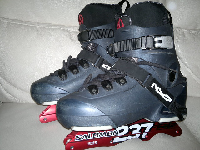

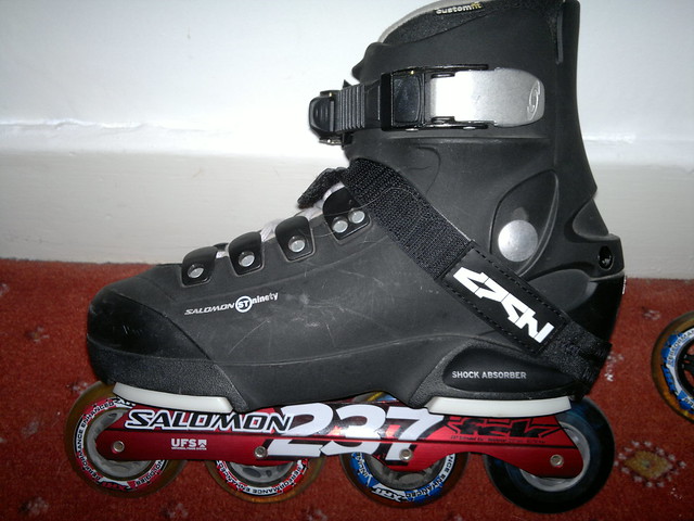

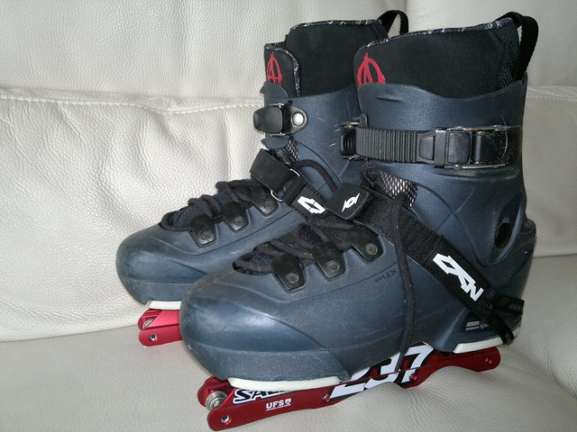

Little bit of an update - been trying to create a suitable backup pair - I guess more for my travels - for my favourites:-
Which so far has taken shape in the form of these:-

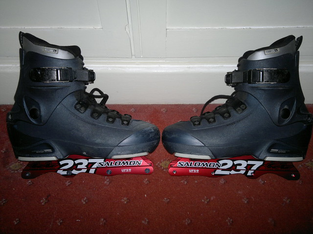

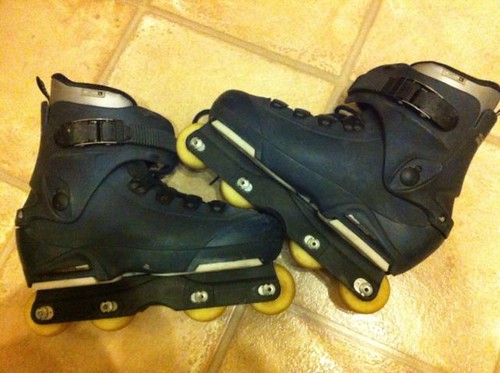

Which originally came to me like this:-
A new set of spangly FSK 237 frames were mounted, and I washed the original liners (on the left in the next pic):-
But as they were slightly larger boots than I'd normally get, I decided to get a new set of liners, that are a bit more padded to fill out the space (the liners on the right in the above pic).

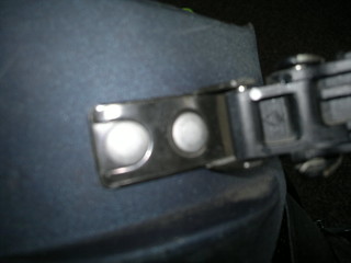

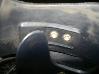

Problem with that is that the stock buckles are modestly sized, and with a liner that's so chunky around that point, the buckles aren't really long enough. If you look at the picture, the boot at the rear, where you can see where the buckle passes through the ratchet, there's barely enough to properly close them without actually wearing them.
Forunately, in my spares, I have several new sets of Salomon (and the odd other make) of buckle. New buckle kits, though, have bolts and tee nut receivers, where as the original / stock buckles are practically always riveted:-
Time to crack out the generic, Maplins-very-own, Dremel-wannabe-rotary-tool-in-a-kit-with-about-5000-different-attachments. Cue the power ballad.
Some minutes later, old rivets and buckles removed, then new, solid, alu Salomon buckles mounted:-
Buckles big enough for a sasquatch.
The boot could still do with some cleaning up / polishing (thanks, WD Pro for all the tips on refurbing plastic) which I'll probably tackle next. I guess what I won't want to do, though, is make them too good, because they're really only playing stuntman or canon fodder for my ST90s.
I've got some new wheels to go on - which is never quite so straightforward with these particular frames, as they make you use two different sizes, because the front two axles are mounted slightly lower than the rears, so max wheelsize 76mm, difference at the front should be -4mm, so ideally (to create a full rocker), a worn 72mm in the front, new 72mm in position 2, new 76mm in 3 and worn 76mm or new 72mm in 4 - so next it's wheels and bearings.

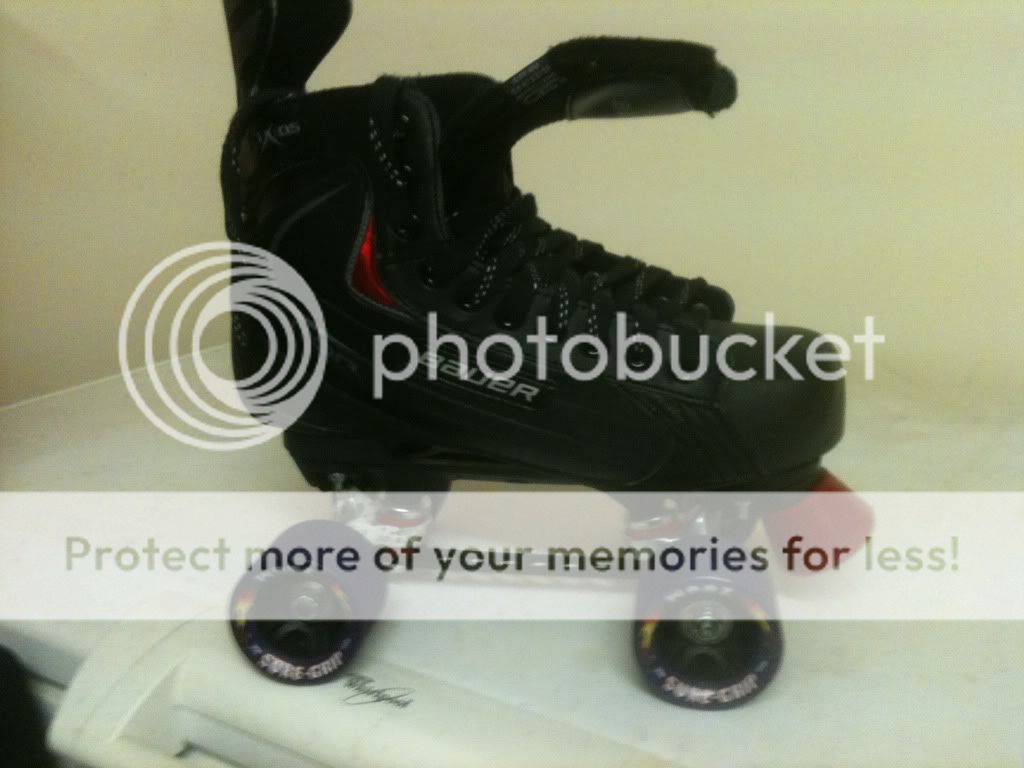

Converted Bauer RX-05's (bought a couple of years ago)

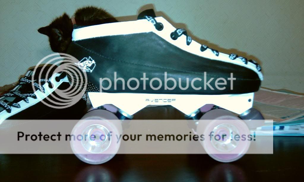

My current skates - Bont Quad Racer Carbon with Sure-Grip Avenger plates and Australian remakes of the old-skool Fanjet wheels & Bones Red bearings (bought these last year - they cost about twice what the parts for my current bike have cost me)

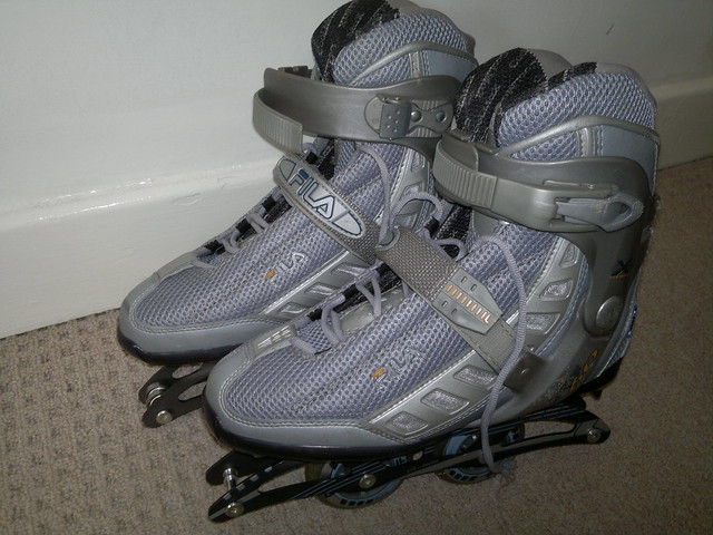

No collection yet and no plans to really start one, but I bought these Fila Master Waves today. Alu chassis, 264mm wheelbase, 80mm wheels (chassis will support 84mm), Abec 7 bearings ... whatever all that means. Paid 80 EUR (£68-ish) for them.
Basically it was a bit of an impulse buy, although I had 90 minutes to think it over.
They look decent enough rec skates - look good for the money. Fila make fairly decent skates - perhaps not quite a popular as some of the bigger, well known brands, but I suspect more popular in Europe. The have a freeskate / slalom range, too which are reasonably well thought of. If you compare them to their rec / fitness line up, they seem similar, but the boot is probably firmer / tougher and more supportive, plus the frame whilst still having reasonably big wheels, and being alu, tends towards a shorter wheelbase and be more compact, than a rec / fitness frame, which tends to make them more manoeuvrable - plus a bit more robust.

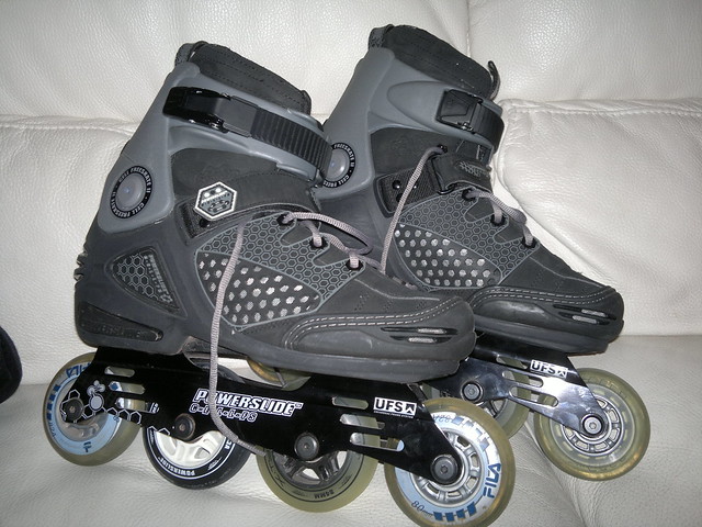

I have a pair of Fila skates, too - rec skates too these are they:-
The frames on those are noticeably longer / bigger wheelbase, than the frames on my freeskates - even my Powerslide Cell IIs which have a bigger / longer frame than some Salomon FSK frames (notably the ones I have - FSK 237s - where 237 refers to the wheelbase) - to allow for bigger wheels and rockering, whilst still being slightly more compact than your average rec / fitness frames.
If you look closely, lower down at my picture of my Powerslide Cell IIs, you can see where I robbed the front and rear Fila wheels from, to create rocker, so I didn't have to rocker the stock 84mm wheels on my Powerslides - because I've got a lot less 84mm wheels as spares.

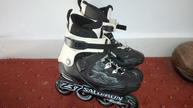

As to my own skates, I've got a new addition - although I've got a few pairs of Salomon skates, I've never actually had a pair of Salomon FSKs - just the frames that I've mated to aggressive boots. I now have a pair of Salomon Deemax 3s - which have the same FSK 237 frames (albeit anodised in a rather less bling, black) as on my awesome ST90s, and my potentially awesome ST10s.
So, here they are - Salomon FSK Deemax 3, and as I was saying before, clearly the early Powerslide Cell IIs (in the 2nd pic) were at least heavily influenced by these, if not more close facsimile:-
Powerslide's frame is different - it's still extruded aluminium and it's still UFS, but designed differently and can take bigger wheels, has no enforced (pseudo) hi-lo thing going on, and has rocker washers on each axle (so each wheel can be rockered in one of four directions). Stock wheels are 84mm, whereas the Salomon FSK frames can take a maximum of 80mm wheels in the rear two axles, and 76mm in the front two axles (not quite the same when mated with my aggressive ST90s and ST10s - the wheel size is further reduced, there, without doing some work / surgery to the bottom of the boot / soul plate, to create some hollowed out recesses that the FSK skates / boots have, therefore allowing slightly bigger wheels - ie the limitations when mated with an aggressive boot are the proximity of the axles to the bottom of the boot / soul plate, when the frames are on a true FSK boot, the limit of the wheel size is the frame capacity - effectively a function of the construction of the frames and space between axles).
