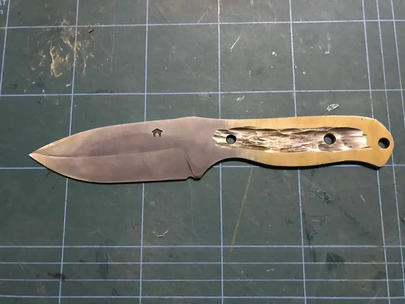

First, more work on the one started on the previous page.
Since the last pics, I refined the shape, drilled some holes, and roughly ground in the bevels. Once I was happy that it was okay, I did three heat cycles (normalising) then heat treated and tempered it. Today, worked from a 36 grit belt through to 400. It's ready for Handles.

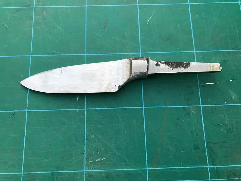

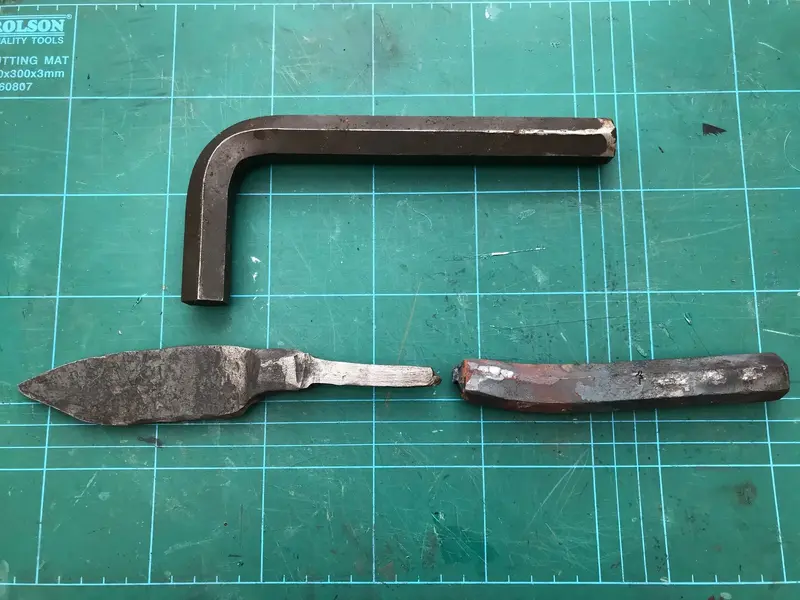

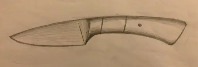

I also had some time to work on something for my Dad. For a while I've wanted to make him a small knife made entirely from things he's used/found. My plan is for a small integral bolster belt knife. The final thing rarely looks like the initial sketches, but should end up *something* like this;
He was a machine fitter so I inherited a lot of his old tools. I'll never have a use for 19mm Allen keys though...

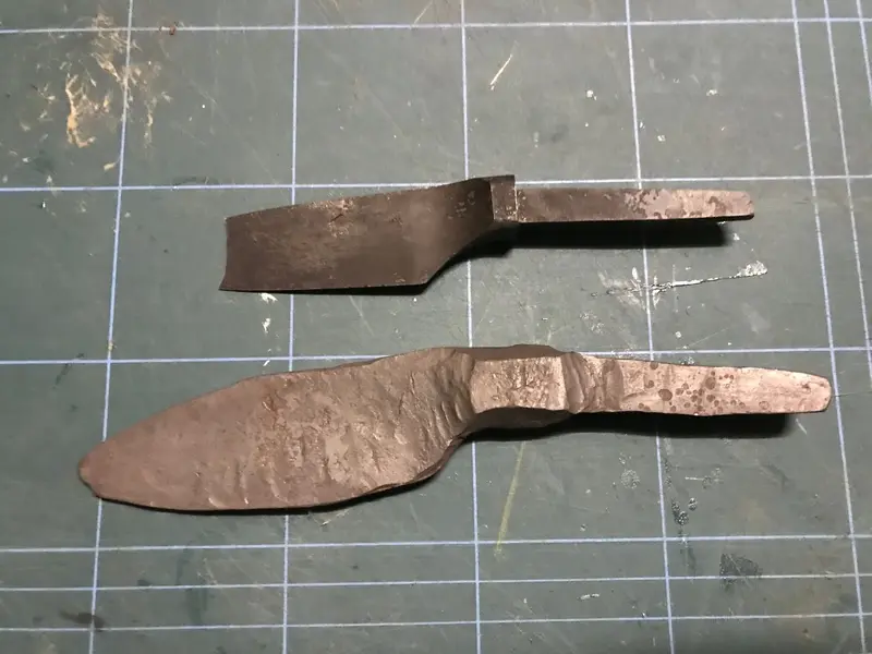

This is what I got done today, about 2.5 hours work;
An untouched 19mm Hex key for reference; For the other one, I straightened it, and roughly forged out the shape - no power tools used yet. I annealed it at this point too.
The biggest struggle is to keep it all square and true.
And then a tickle with the belt grinder - all at 36 grit at the moment, so still very rough.

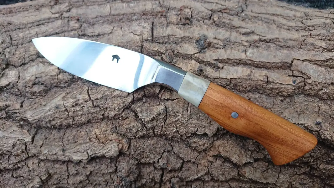

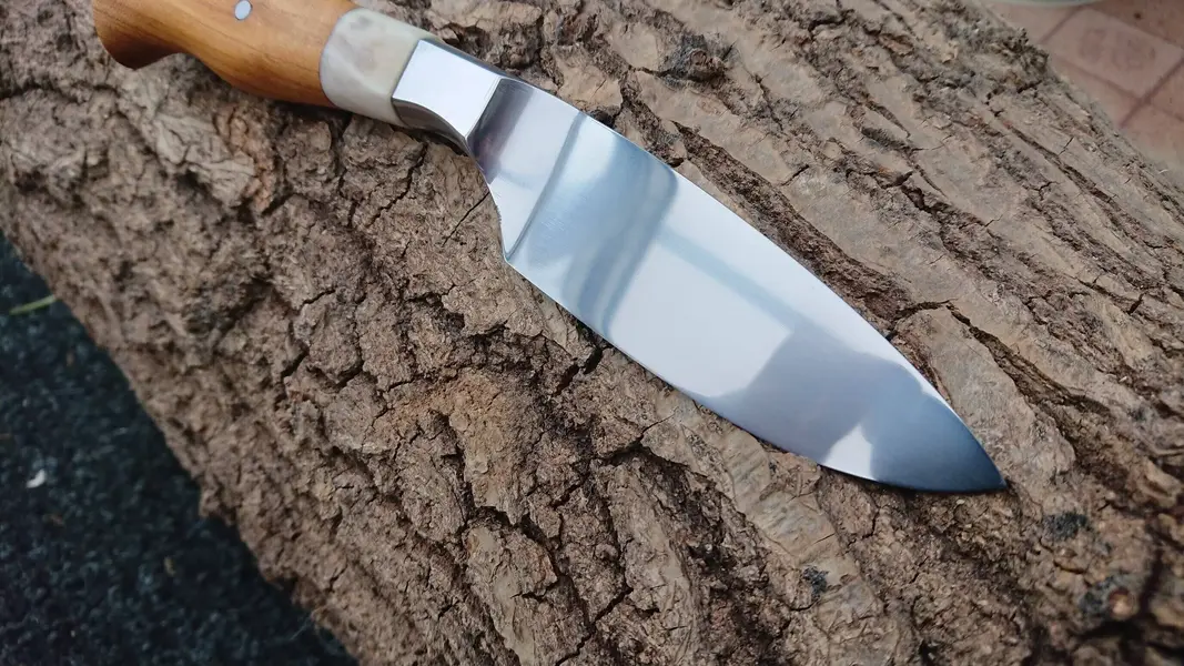

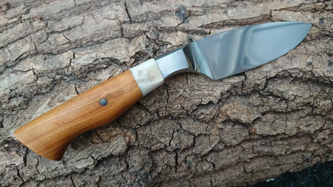

The knife for my Dad is almost finished now after a few false starts. The left side of the blade needs more polishing and I haven't added the edge yet.
It's made from a 19mm hex key, Antler he found in the local forest, Oak from his garden and one of his old drill bits. The blade is 3.5" long and the overall is 8.5"
Overall, I'm pretty happy with it.
:cool: excellent.
Im sure he will be well chuffed, and using those parts just makes it that bit more special.

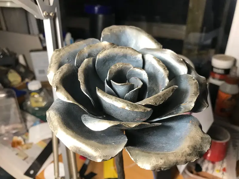

Well, I've got one Happy Pappy; he liked the knife. I thought i'd better make something for my Mum too, so knocked this up;
It's set in the same block of oak that the knife handle came from, but I forgot to get a pic. 🤦
