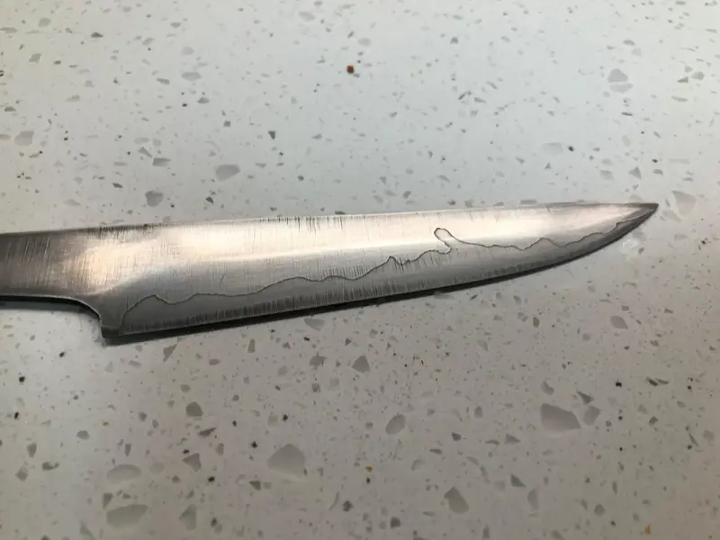

I managed to gain another inch of blade, thinned it nicely, reshaped the handle - all was good. Heat treated it and a sliver or the outer layer came away. It was paper thin and didn't like the quench. One side is *perfect*, the other had too much removed yesterday due to a single hammer blow that left a mark too deep. As I ground it to remove the blow, the outer layer became too thin :(
Perfect side (it's had a quick etch to show the layer)

So close...

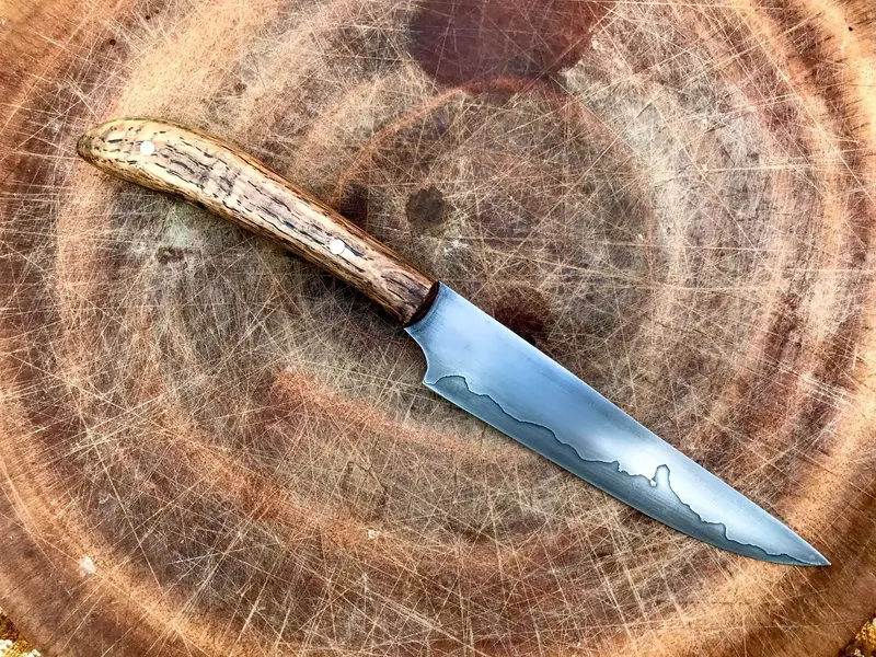

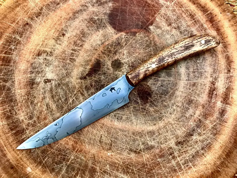

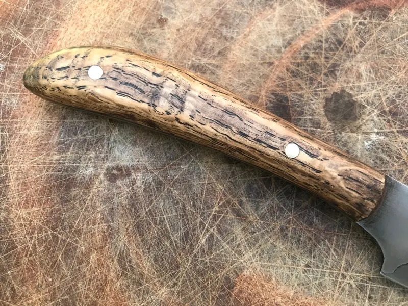

3 layers of steel forge welded together (1070 core, 15N20 outer layers) total length 9.5" with a 5" blade. Coffee stained Oak handle with Brass pins. IMG_0218.jpg IMG_0219.jpg IMG_0220.jpg IMG_0217.jpg
I like that a lot - reminds me a Masamune Katana with those nioi
Sorry for not keeping up (perhaps just looking at the pics rather than focusing on the words .... ) what’s the little house inprint for
Hey Spudly. A Nioi (Hamon) does look similar, but it's not something I've tried yet as it doesn't show in all steels. They look amazing when done well.
The 'doghouse' is just my makers mark/touchmark :)

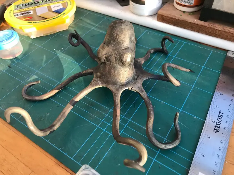

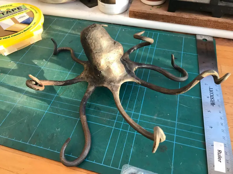

What do you do when you have a few days off, and can't go out to play? Make an Octopus, obviously.
He's made of some 2" gas pipe and rebar.

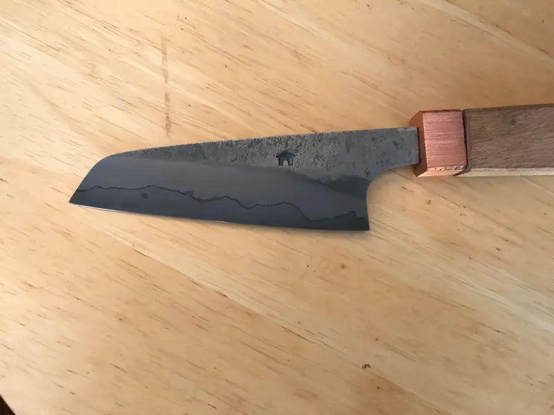

A mini Santoku for the wife. Obviously not yet finished, I tend to do the forging when the weathers cold and handles when it's a bit warmer... my garage is cold...
15n20/1080 Sanmai, with a copper bolster and Sapele handle.

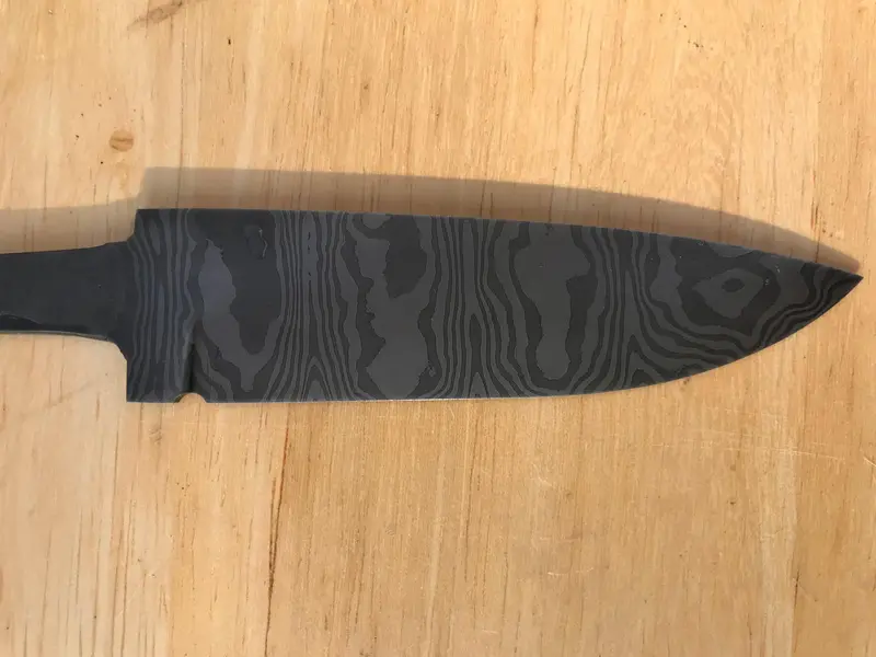

And a nice little damascus bushcraft knife (4" blade). About 24 layers of 15n20/1080 in a ladder pattern.
undecided on the handle for this one at the moment.
freddok":15hrro98 said:
Gorgeous work !!! Congratulations !! I'm in love with the octopus...
dyna-ti":15hrro98 said:
Mount the octopus on a long pole with a base to make it stand up securely and use it as a coat stand :D
Thanks Guys. The octopus will be getting a fish friend in time... The coat stand is a nice Idea, but there was another plan for him :)
