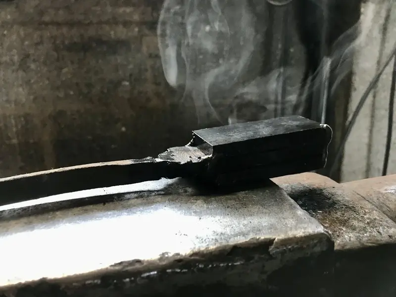

Spent 2 hours hammering this into a single 25cm long bar about 10mm thick cut it into 3, stacked and welded it then had to leave it.
![BF1A4881-9318-47FA-BA27-ACD7692C071D.jpeg BF1A4881-9318-47FA-BA27-ACD7692C071D.jpeg](https://www.retrobike.co.uk/data/attachments/539/539596-ce978316f1be7c1e4e078a266767b322.jpg)
![2F30F2E6-42C6-4B8E-8CD7-F5F505623BAA.jpeg 2F30F2E6-42C6-4B8E-8CD7-F5F505623BAA.jpeg](https://www.retrobike.co.uk/data/attachments/539/539597-0e548ec719a8b6fb6e8d6596d8f0781f.jpg)
Total Layers 360 (although not yet welded!)
Total weight ??
Total time so far 6.5 hours.

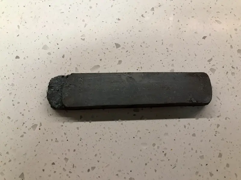

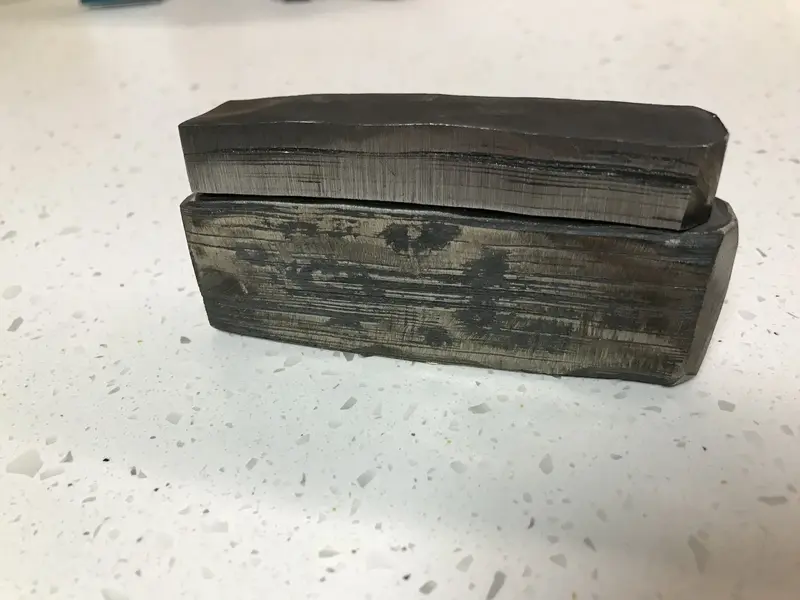

Then we get to the ball bearing canister... I don't like full tang knives for many reasons, not least I don't enjoy making them as much as hidden tang. However, I have a lot of handle scales that need using up, and should have *just* enough steel to make this work;
![3FF0FA9D-E95D-4314-BA71-E9A5F18F5CF2.jpeg 3FF0FA9D-E95D-4314-BA71-E9A5F18F5CF2.jpeg](https://www.retrobike.co.uk/data/attachments/539/539598-37df233b1f458eced528947a249070d9.jpg)
A nice little bushcraft style. This billet weighs 354g.

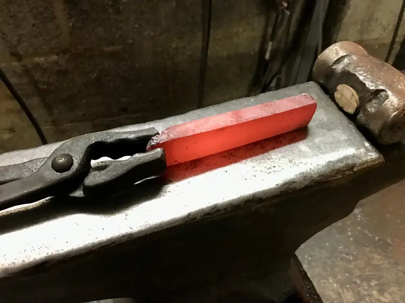

Lots of hammering, heating and yet more swearing (burnt my hand as a bit of scale jumped between my finger and the hammer) and popped in Ash for a long while to cool super slowly and anneal (soften) the steel.
