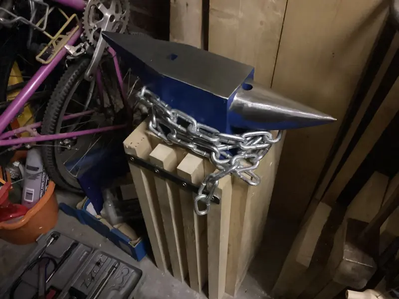

I am making a stand for my little anvil at the moment. Just pondering how best to screw it down. I think I have a plan.

Check it out:
One cheap Chinese steel anvil installed on a scaffold board stand. I’ll have to wait to try it as I’m away with work all next week!
you can just see the frame of one of the fleet there as well!
if you find the anvil 'rings' when you hit it (and you'll know soon enough!) take it off the stand, cover the bottom of the anvil in cheap caulk/silicone and slap it back on. Best thing I ever did. *TIIIIINGGGGGG* became *thunk*.
Yup, already done! It shouldn’t move either. I used threaded rod straight down 90mm to 8mm flat fitted into slots cut with a router.
