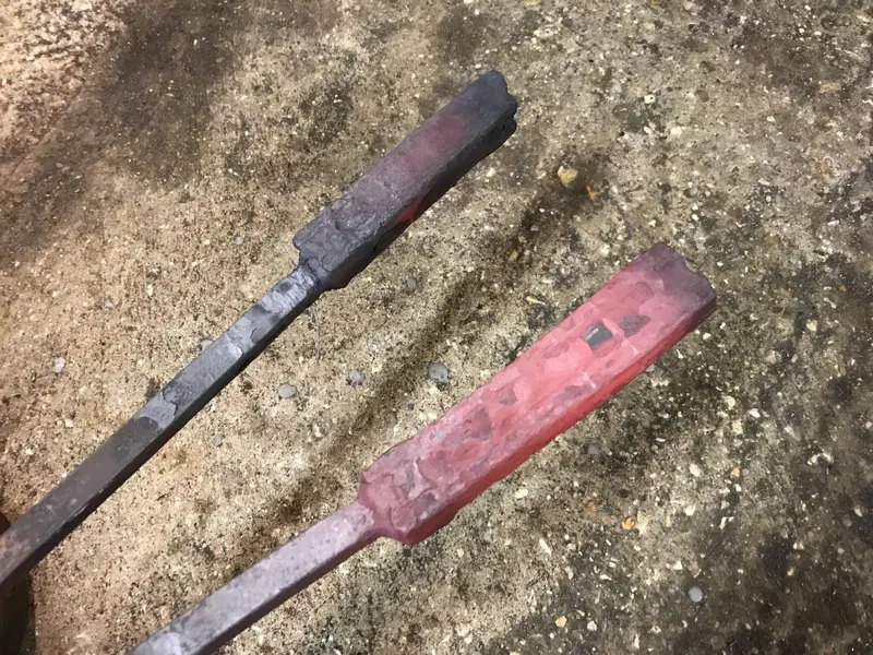

You can't see it in the previous pics, but I've drilled a small hole in the cap of each canister to vent the pressure. What I , accidentally, managed to do was weld straight back over it on the chain canister... BOOM!!.. There may have been a small explosion with lots of lovely sparkly dust... I welded it back up, drilled another hole and carried on...
These get soaked for about 25 mins at 1000-1100 degrees, then smashed in the press, repeat a number of times.
Then *try* and peel the canister off...

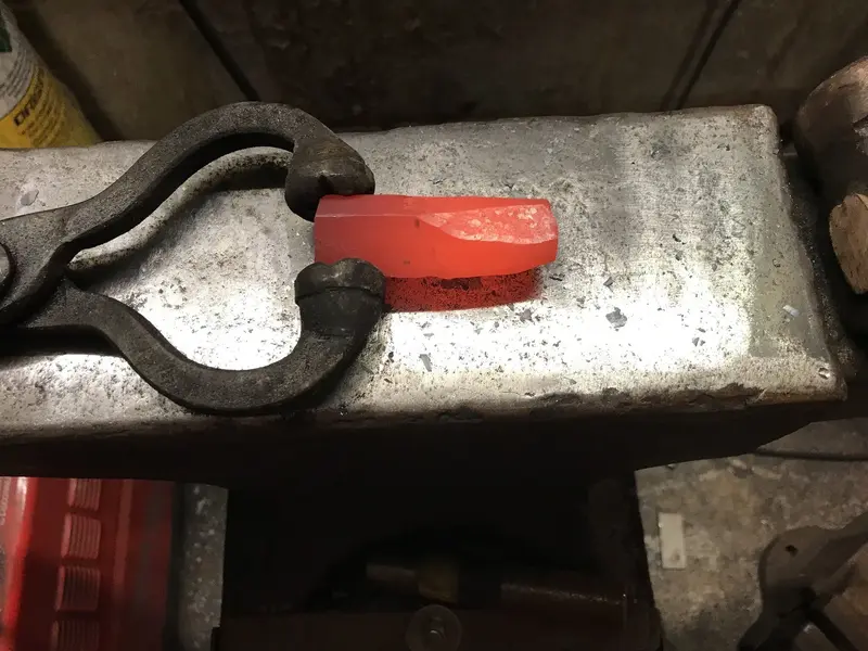

I haven't tried on the chain yet, this is the ball bearing one after removing the mild steel canister and starting shaping it;
And some SmashySmashy makes this (You can actually see the pattern on part of the edge)

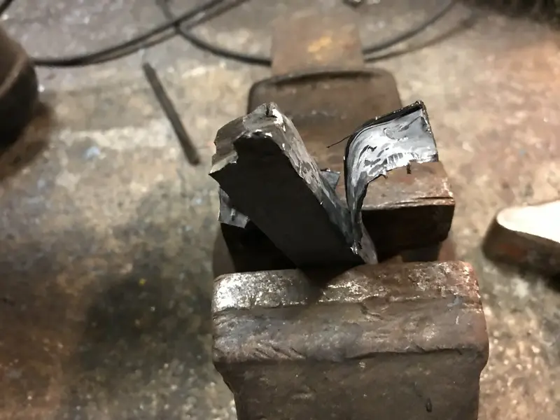

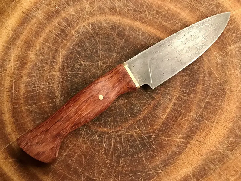

Finished, albeit not yet sharpened.
Ball bearing canister damascus (1000 carbon steel 3mm balls & 1095 powder) Brass bolster & pin, bubinga handle. 4.5" blade, 9.5" overall. Thin and light at 2.25mm thick - a slicer not a chopper.
I learned a lot, not least that Weldtite use plain (cheaper) carbon in their bearings - I should have used a higher grade 52100 (at about 4x the price) for better contrast. the 1095 should etch much darker than the bearings if they were 52100. Off to it's new owner once I make a sheath and sharpen it. I am pleased with the heat treat; this blade is HARD and will flex pretty well too.
