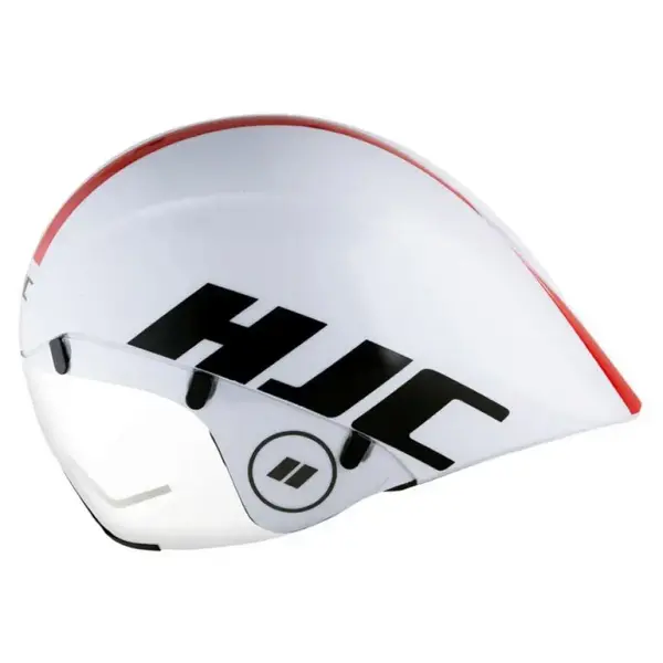

I went helmet shopping, this is on the way, HJC Adwatt Time Trial helmet.
It was the winner of what works vs what does it cost competition...
