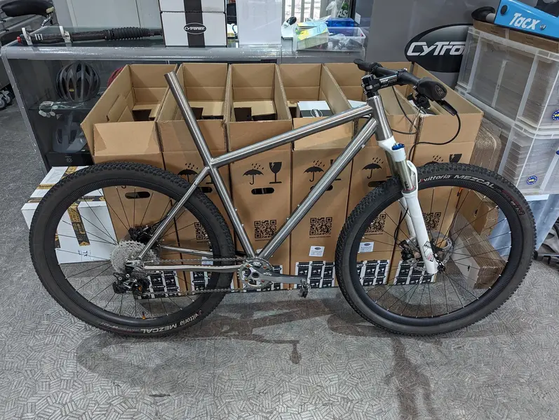

My KCNC ISP topper came today so on my break I got to work building up the bike.
Getting there! Brake hoses defo need shortening at some point.

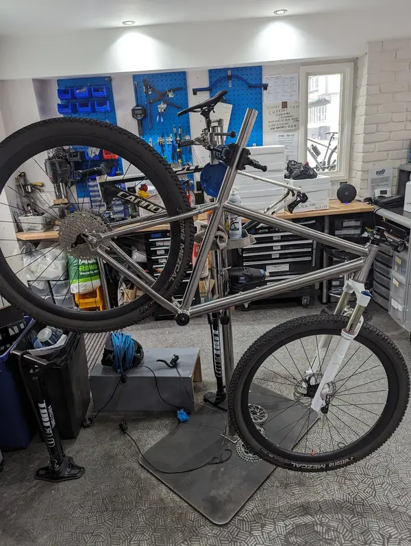

I took a long time measuring the cut in the seat tube. My topper only has 20mm of adjustment so definitely didn't want to take too much off! I had to cut 65.5mm off.
I couldn't finishing get everything put onto the bike on my break and had to finish it off at the end of the day. Really happy with how the bike came out. It weights about 10.4kg in total so not unhappy with that. Sub 10kg would be possible by replacing saddle, grips and bars for carbon. In fact, I intend to get carbon bars anyway but not yet. I will also replace as many bolts with Ti as possible. I just want the bike to be as corrosion resistant as possible since I am committing this to be my last bike for some time (he says!)

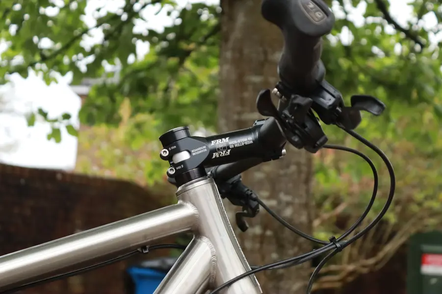

The fork steerer could be trimmed a smidge. I rode the bike home and back to work today. Only about 30 miles total. I have to say everything feels great. The frame is solid and the 34.9mm ISP is not as unforgiving as I had expected it to be!
I have not ridden non-lefty suspension fork for years and its odd - my balance feels slightly off. On the second ride, I didn't have the feeling nearly as much as the first ride. The geometry was meant to be an exact copy of the Cannondale Flash but i am running a 100mm stem instead of 110mm and the axle to crown on the Flash was a little shorter than this bike so my position feels a bit different but certainly not uncomfortable.
As with all builds, I need to make a few tweeks. Saddle nose needs to come up a degree or two and the saddle needs to come back a tiny bit too. I think I could also trim another 10mm off the ISP so that I have adjustment. I cut it perfectly and with the seatpost topped bottomed out my position is correct but it means I can only increase the saddle height from here and cannot lower it at all.
I will also get a carbon rigid fork at some point. I don't ride off road nearly as much as I should and when I do, even on rigid forks, i'm alright. Plus it'll lightly the bike up a chunk for commuting and nipping around the New Forest.
I've not had good luck with bike frames. 5 of my last 6 have cracked or snapped so I am hoping for better news here. I suppose there is always a gamble when buying something which will be hard to warrant, purely based on distances involved. However, my experience with Titan have been great and hopefully the only thing that goes wrong with this bike will be due to an accident instead of workmanship.

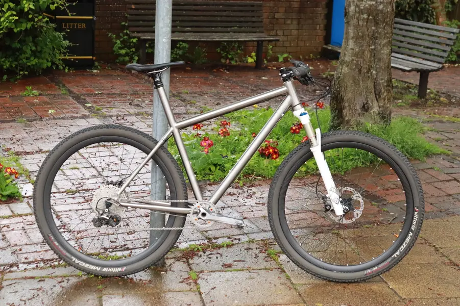

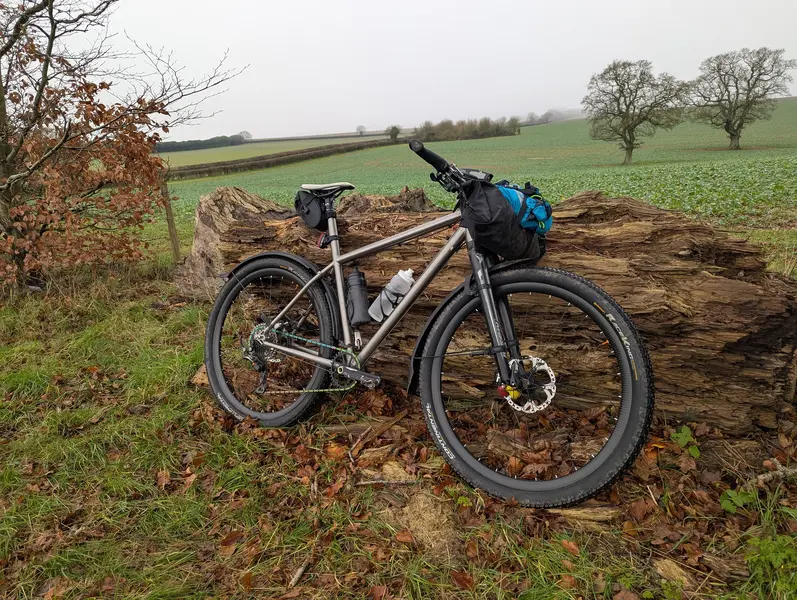

Had this beauty for over a year now and a while back I made a few changes.
Played around with a few rigid forks but ended up sticking with the same suspension forks...but now have rigid envy again 😁
I changed the saddle to a Ryet 3D one and have found that to be a great fit for myself.

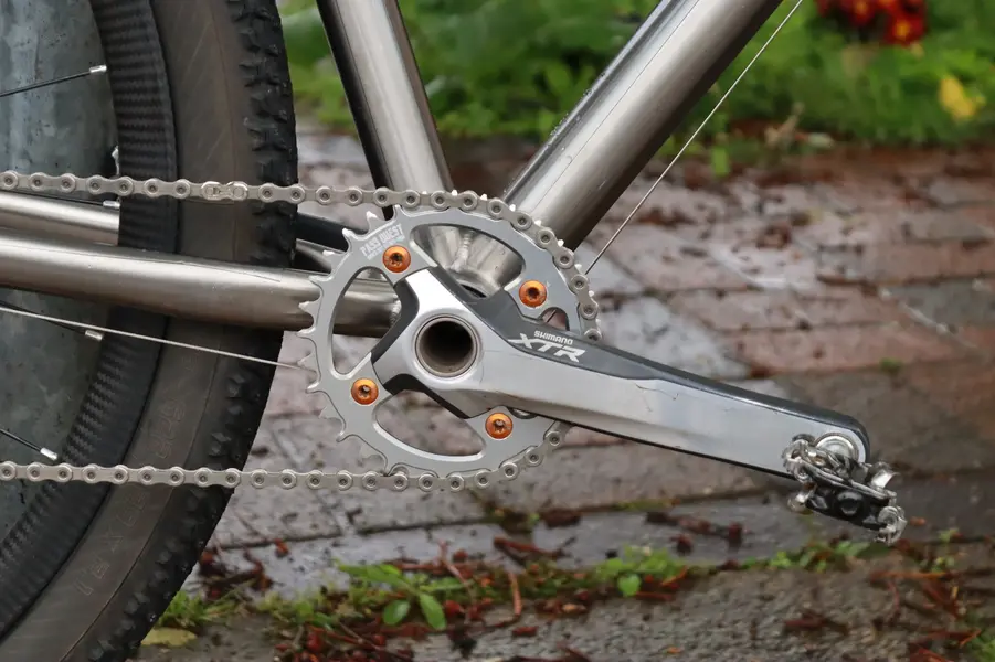

Cranks have been changed from xtr to Cannondale hollowgram and tyres changed to continental race kings in 2.2 over the 2.1s in Mezcals.
Still loving this bike and In the next couple of months, I want to take the bike on a weight weenie spree. It'll never be super light as the frame is heavy but I also plan to chop off the ISP in change of a carbon post...but that'll come later.

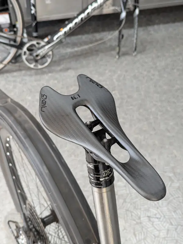

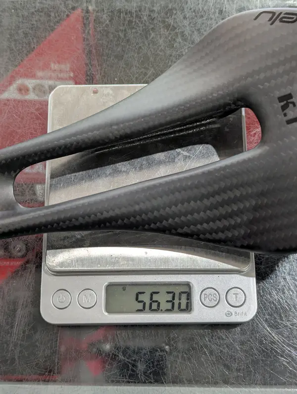

Next update: some parts just ordered...
-Gelu carbon saddle
-darimo stem
-additional carbon wheels
-ai2 rotors.
I am not sure about the wheels, They are a bit of a gamble and will require some adapter that I need to agree on. Most of my riding is on road anyway so the wheels are techincally a "road wheelset" but they are wide enough for my needs and tyre choice. So let's see. Wheels are supposedly less than 900g so now my wallet and bike are going to be a bit lighter than before :D
I was going to build my own wheels which with my choice of parts were about 1050g. I thought I could do better than that hence my claim above of the wheels being below 900g. I have had a pic from the manufacturer and indeed the reference set were 884g. Technically they are a road wheelset so i do need some 15mm to 12mm adapter to run a smaller front axle but the rear wheels is still 142x12mm which fits my bike.
Lead time approx two weeks but since most of my riding is on road anyway, I fancied giving them a go!
Most of my new parts are here now. So thats saddle, stem, tubeless valves, centrelock adapters, some ti bolts (don't need the 12 for the rotor bolts, my bad!), carbon stem spacers. Just waiting on the rotors and wheels to arrive and then I'll get nerdy and all weights onto a spreadsheet and takes pics. I suspect wheels will be okay for commuting needs but certainly not for anything rough. Same goes for the saddle which is only 54g....and we wait!
