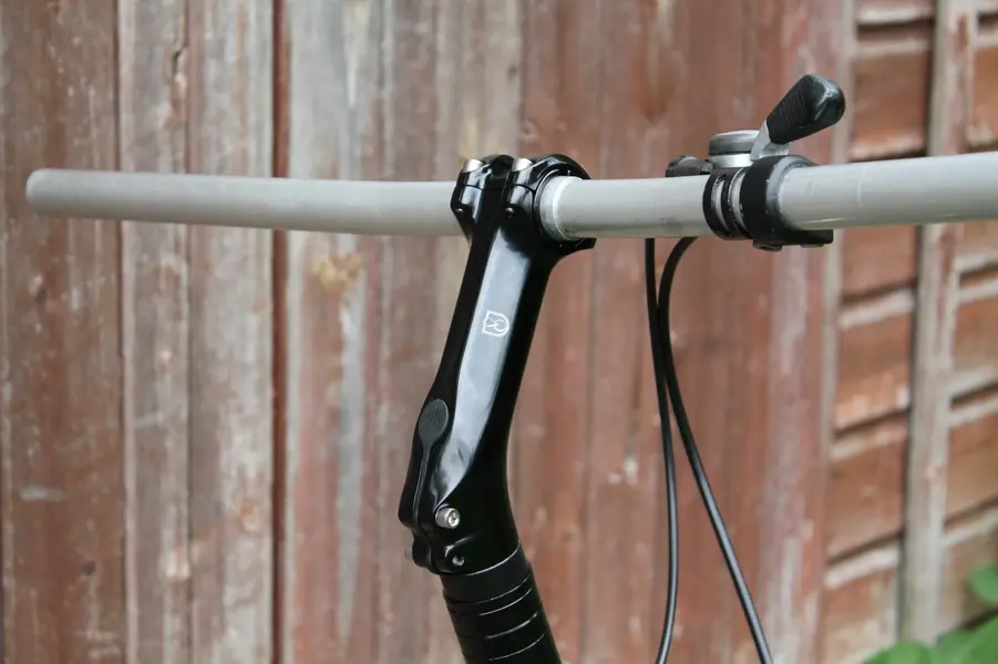

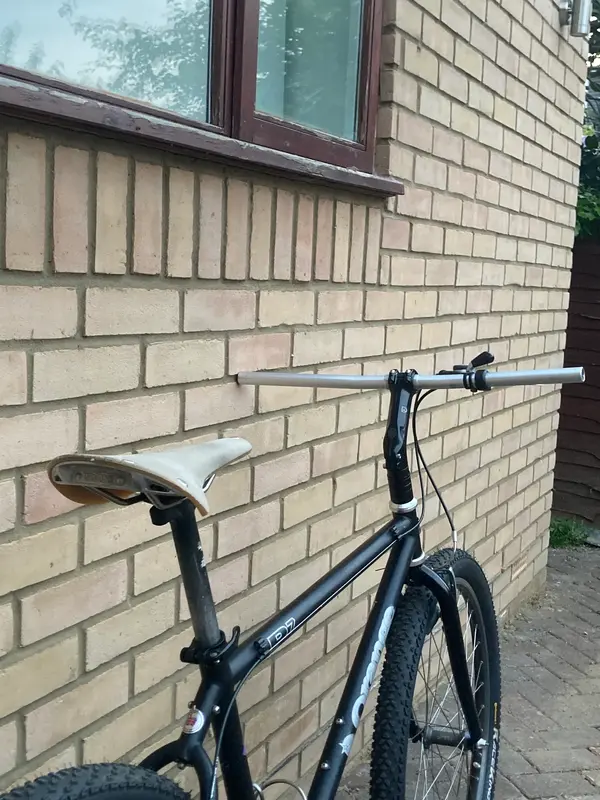

Here's where I got with it today. VO Happy stem came in the post and fitted it. I'm obviously still learning about bike fit and after looking at some photos of 90s mountain bikes built as bikepacking/touring rigs I noticed that hardly anyone has bars much higher than the saddle, and when they do, it's usually just by an inch at most.
I was trying to match the fit to my other bike that I cycled to Bristol on, but turns out it doesn't work that way. I had 100mm of spacers on this along with this stem and it just felt like a completley upright bike, way more upright than my Kona, despite the rough measurements being the same. The top tube is shorter on this and the headtube slacker and I suppose that influences fit quite a lot! I slowly lowered the bars down, and ended up cutting 25mm off of the steerer tube and I've ended up with this, the bars just a smidge higher than the saddle.
It feels really, really good like this. I've never ridden a bike that I feel so in control of. Standing up on the pedals feels super effortless and I'm able to move my body weight around really comfortably. I'm planning to get a riser bar to allow for more reach adjustment anyway, so I'm thinking to cut the head tube more and knock it down 40mm or so. Then with a smidge of saddle nose up/down and setting the position on the rails right, I think I'll have a bike that fits!
Ordered a Pelago Commuter front rack too, and went a slightly different path with my front bag choices. Will be revealed soon!
