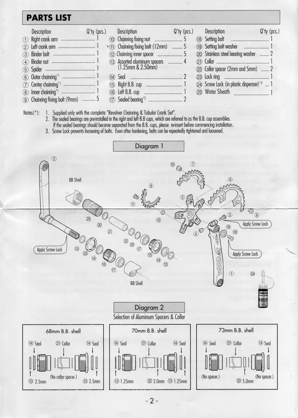

I fitted these tonight, in time for my weekly group ride on Friday night. The NOS cups and new bearings arrived, and were installed within the hour! 😂 Needless to say, I was eager to get these on the bike, and I love how they look. They are so easy to adjust, and I can take the cranks off in less than a minute, so chainring swaps, and the inevitable repaint will be nearly effortless.
I noticed that the previous guy used an unnecessary 1.25 and 2.5mm spacer in the stack, so his cranks were not installed properly. Nice that I have them though, since I can now get them reproduced, along with the missing setting bolt washer.
Since I don't have a BBT-7 for the proper Revolver lock ring adjustment, I decided to use the one from the Tioga fully adjustable bottom bracket that I removed. They are nearly identical, except the Revolver one is smaller in diameter by a few millimeters. This makes all the difference when using a standard Park Tools HCW-5. Also, the water sheath from the old Tioga BB is identical to the one from the Revolver, in case you can't source one easily.
Lastly, here is a clean scan of the parts list, without annotations, curtesy of holden.
